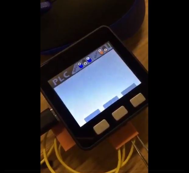

        The pic below shows a PCL (programmable logic controller) module for the M5Stack that supports Can and RS-485. It hasn't been released yet - the pic was posted on twitter Jan 24 2018. Seems like release might not it is too far away... Presumably support will be added then. A brief PLC test video as per pic below has also been tweeted...
        I don't see any reason why the current model M5Stack with 4 MB PS-RAM would not support the PLC module.

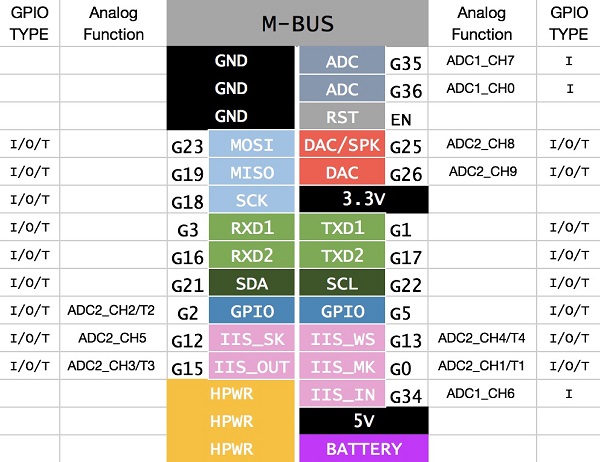

            Here's the current M-BUS layout for those playing along at home.... wanting to compare:

                we still can use GPIO35 as CAN RX and GPIO5 as CAN TX (this config is used by Olimex EVB Rev B)
                Personally I haven't tested GPIOs pair 35/5 but pair 4/5 works very well with arduino lib

                    gpio's 35/5 are available on m5stack header
                    and additional transceiver may be soldered, as You wrote, on the add-on module.

                          Hi. Thanks a lot for the feedback. Thats exactly what i was locking for. Need to add a can transceiver and used the pins 34 and 35 for the CAN connection. I would like to build a simple can logging monitor.
