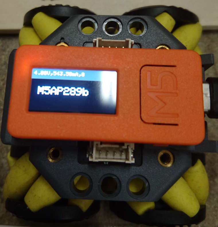

                      For charging Rover C as well as Joy C the M5StickC must be installed. Then the switches on Rover C and Joy C are switched on. Then connect the USB cable to the M5StickC and start the charging process!
                      At Rover C you can see the charging current and voltage on the screen of the M5StickC.

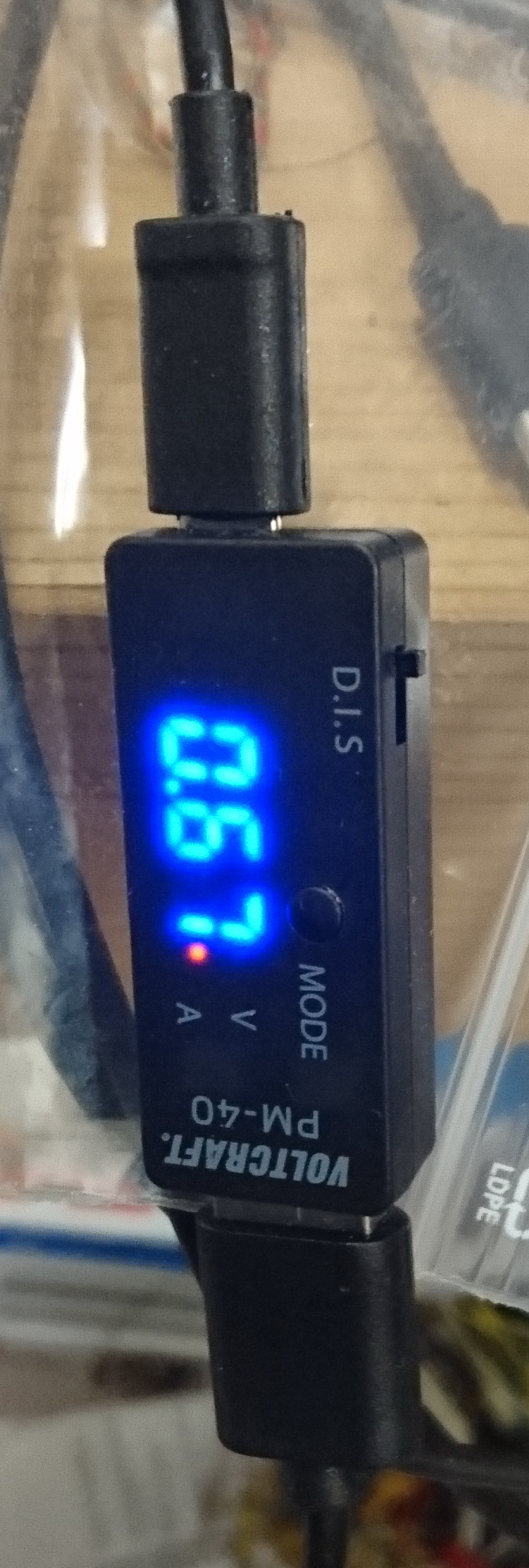

                      On Joy C this display is unfortunately missing, but through my USB charge controller I can also see when Joy C is full.
                      Here is a picture with charge control on the USB port.
