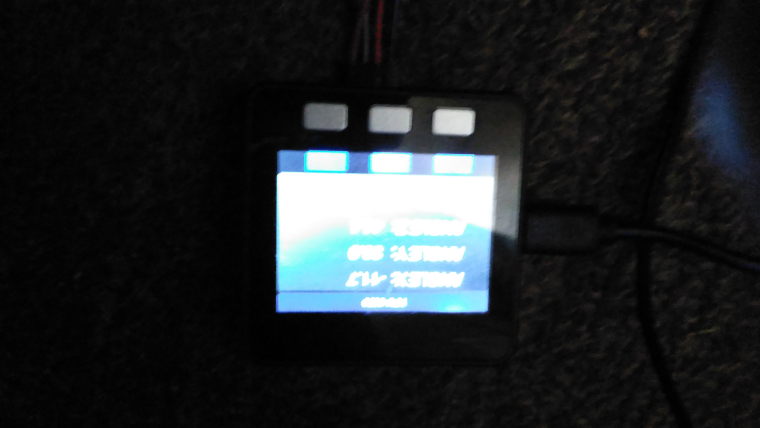

                        Since oscillo works, you can also graph FFT and from that detect Hz +THD.
                        Benefit: detects the quality of the electricity and helps troubleshoot and predict issues.
                        I started a project on that, measurements are out of wack, maybe we can work together on it?
                        https://github.com/laurentopia/M5-Signal-Multimeter
