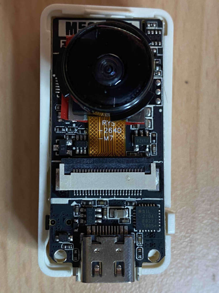

      Hello,
      I am an owner of a M5Stack fish-eye wide-angle lens cam. I want to install the cam in a small intercom. The space is big enough for the M5Stack cam but only without any USB-C connector. Is there another way to supply the cam for example inside?

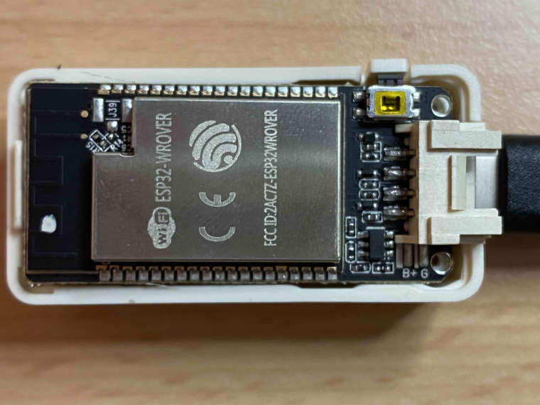

        Hello,
        I am looking for the GND und Vdd/5V-Pin IN my M5Camera at the picture. Can anyone help me?

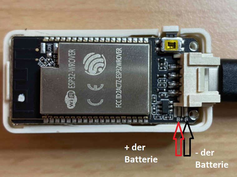

            Yes you can use the B&G connectors to power it.
            M5Stack created a battery back just for this purpose
            https://m5stack.com/collections/m5-base/products/m5stack-battery-base?variant=17508549820506
              There you can also see in the pictures how the battery is connected to the respective camera!

                @skink and @ajb2k3 Thanks for your great help, this is a good solution.
                I think I have to use 3,7V and not 5V because it is battery pack input.
