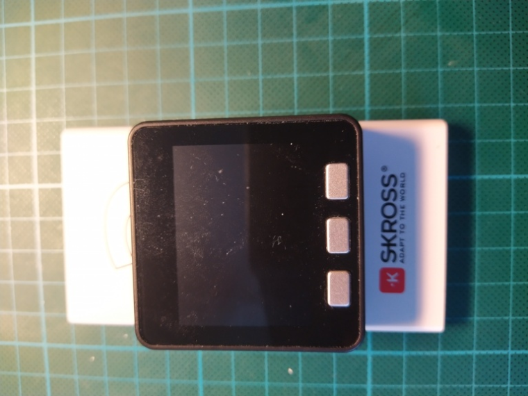

          The simplest thing is to use a powerbank: The square ones mostly are powered by a18650. Today most powerbanks are designed pass through, so you can charge them and at the same time powering a device as the cellphone, the M5Stack, -stickc or the atom (matrix). I mostly hock up my M5Stack devices to a powerbank instead of an USB wall plug charger when programming them over WiFi with an API Key. My M5Stack runs up to 48 hours on an 3500 mAh power bank. I'm also using a nice square one 100x50x10mm from SKROSS (3 Reload) which fits nicely with the M5Stack.

            @crami25 the question was not related to the M5Stack but to the M5StickC. And most powerbanks will only work for a few minutes. this because the current is to low and the powerbank will cute off the power.
            The 18650C will provide 3.7V direclty to the LDO regulator. to convert it to 3.3Volt.
            With a powerbank you will loose power. from the step up converter. 3.7V to 5V and later a step down, from 5V to 3.3V

              My Skross (and other powerbanks) work fine with the M5Stick (and Atom matrix), they don't switch off. Maybe you got an old style one. The newer ones are made that you also can charge earplugs (with batteries smaller than the M5Stick) without shutting off. Never mind the power loss. Modern step up and step down have a power loss < 5% . Maybe you want to use a cheap 18650 from Bangood (I got 4 of them marked 5000mAh !) as a backup power. I will stick to my powerbanks. You probably will loose 4-5 hours of run time (of 48). By the way, the IP5306 used for the power management in the M5Stick according to the data sheet (http://www.datasheetcafe.com/ip5306-datasheet-battery-ic/) supports a 2.1A charging current. So it should be no problem charging a 18650.

                @crami25 thanks for the advice. I've used branded and unbranded powerbanks. The modern powerbanks require a minimum current consumption. the older don't.

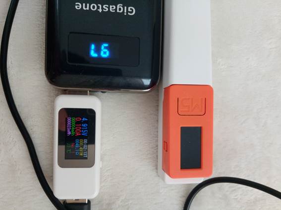

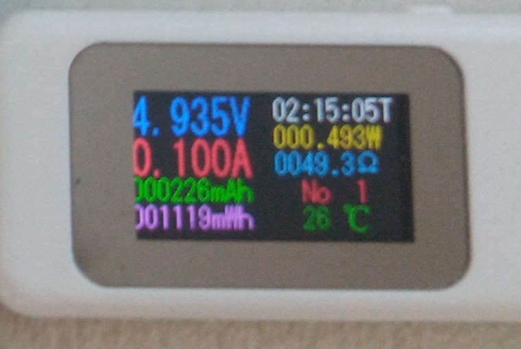

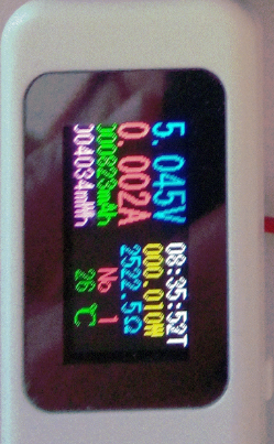

                        • liemphL Offline
                          liemph
                          @kees said in M5StickC and 18650C endurance:
                          @Pepsi BTW, how much time does it take to fully charge the battery? Does probably depend on the charger, but just to have an idea.
                          Today I did an experiment to measure the time and the current needed to charge the battery. In short, it needs around 8 hours, a steady current of 100 mA, and the final reading showed that the battery has a capacity of around 800 mAh. I can't be sure that I discharged completely before charging the battery. But hopefully, this will give you a rough estimation.
                          • liemphL Offline
                            liemph @Kees
                            @kees After 2 hours charging
                            • liemphL Offline
                              liemph @Kees
                              @kees Finished after 8 hours charging
