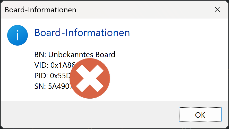

    C
    @mrconstanti, I found on Win 11 don't work really the USB / Serial driver from M5Stack. I found after some own Trouble with can't find device the driver developer with an update driver also for Win 11. (Driver year 2025) I test, unknown device still exist, but I think with Arduino IDE can work, until now my own project stopped with some other errors, so I'm not sure to 100% but if help other and you. wch-ic.com Kind regards Chris

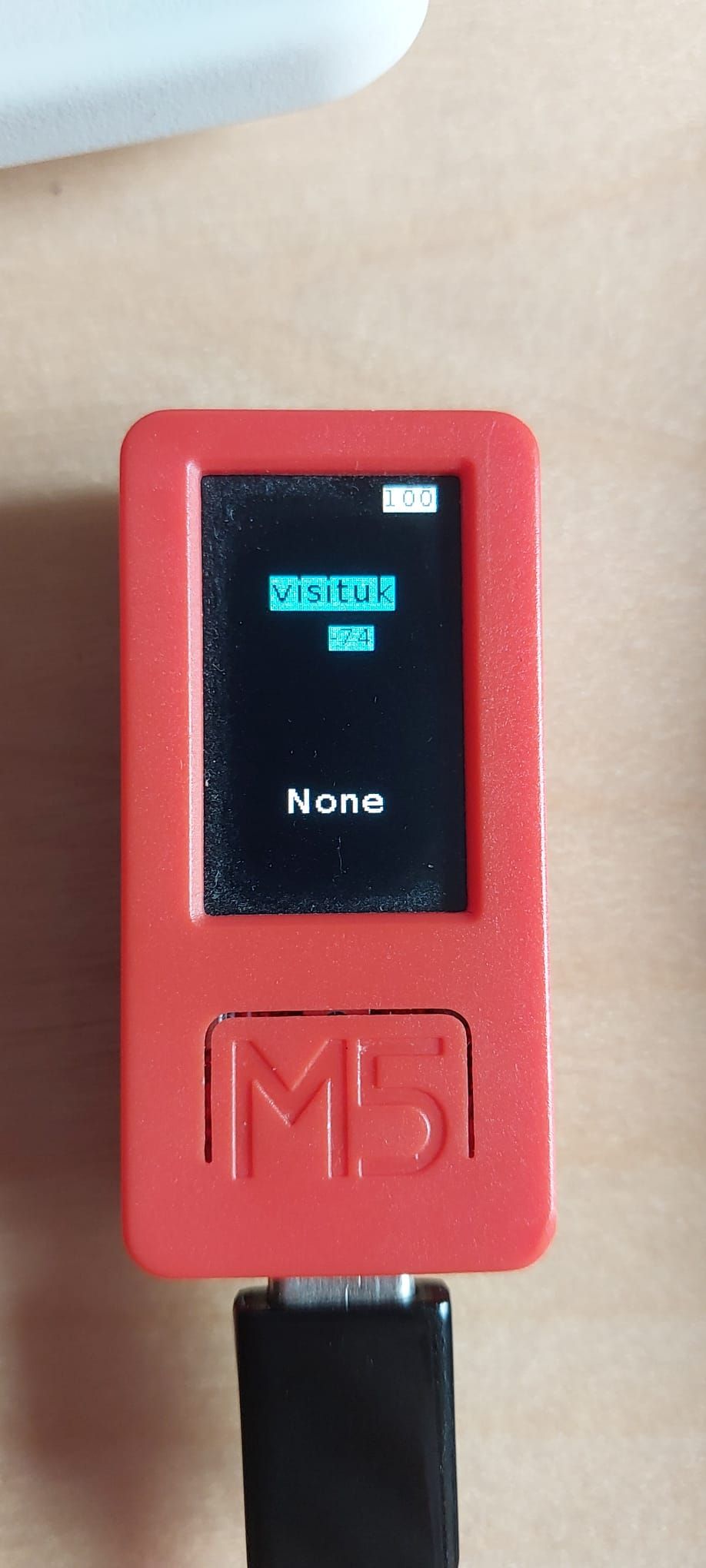

    S
    Thanks @robski. I tried the latest 2.3.1 , the oldest 2.0.3 and more. I just tried again, Now it works with 2.0.3 and up to 2.2.6 2.2.7 and newer ones i get this weird black screen with some elements showing up when pressing buttons, as in the screenshot above. in some cases, i could not burn a lower version until i used the erase option before burning. EDIT: now i realized with 2.2.7 and up to 2.3.1 although the screen is black on bootup, it connects to the cloud and i can send programs to it. So, form 2.2.7 on just the UI broken.
