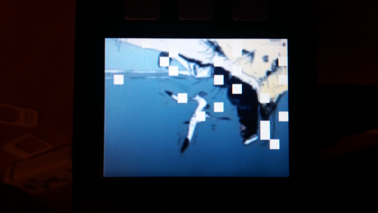

        • R Offline
          Richard
          my jpg 320*240 on sd
          i have m5stack core 0.2.0
          • C Offline
            Calin
            That problem is caused by SPI frequency.
            Try to lower the SPI frequency from TFT driver then it should work just fine.
            In most cases, 27Mhz SPI work just fine with most TFT's.

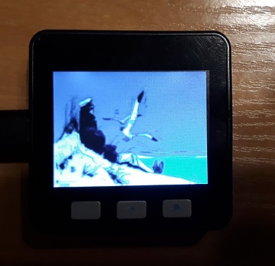

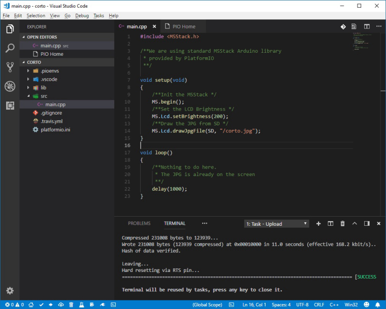

                                Calin
                                Here is the test using your code (with small modifications and relevant comments)
                                and standard m5Stack library from PlatformIO:
                                And here is the result:
