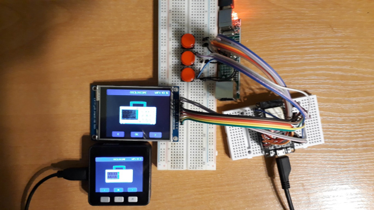

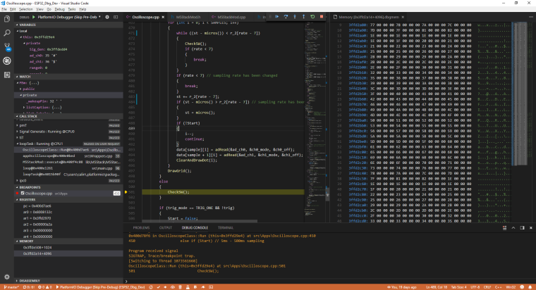

                        Here is my M5Stack debug setup: a "home made" Jtag, some ESP32 board and a ILI9341 TFT.
                        And M5Stack device running (almost) the same code :)
                        Too bad the actual M5Stack don't have a touchscreen... i can use the touchscreen on the debug "setup" :)
