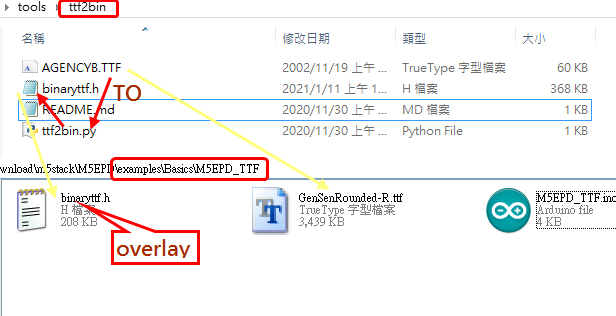

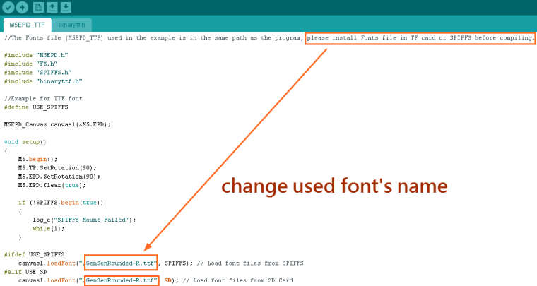

            1.Download source code
            https://github.com/ayoy/fontedit/tree/v1.1.0
            2.Open m5stack\M5EPD\tools\ttf2bin
            Please specify file path. Like "ttf2bin ./font.ttf" or "python ttf2bin.py ./font.ttf"'
            get new binaryttf.h
            3.Overlay binaryttf.h used new binaryttf.h to \examples\Basics\M5EPD_TTF
            PS. please install Fonts file in TF card or SPIFFS before compiling.

                      @powersoft I got the M5EPD_TTF example running using the GenSenRounded-R.ttf file copied to my SD card. It displays some differently sized flowers, some unicode math symbols and left/right arrows to show top-left down to bottom-right labels.
                      I removed all the addtional example code to just read the font from the SD card, so the setup starts like this:
                      void setup()
                          M5.begin();
                          M5.TP.SetRotation(90);
                          M5.EPD.SetRotation(90);
                          M5.EPD.Clear(true);
                          canvas1.loadFont("/GenSenRounded-R.ttf", SD); // Load font files from SD Card
                          canvas1.createCanvas(540, 960);
                          canvas1.createRender(48, 256);
