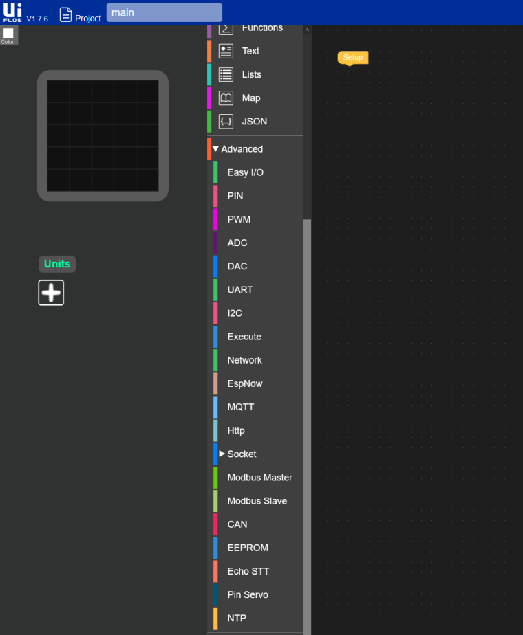

      I'm new here, just picked up my first device, an M5 Atom Matrix.
      I've spent a day watching videos about UI Flow which is a really neat way to get started. The only notable omission is - no Bluetooth!
      It lists BLE as a feature on the box and it is supported by the processor, but just not exposed in UI Flow.
      This is sad as its a big step from using M5 Burner and UI Flow to get started so easily to now compiling MicroPython and bundling packages into it that I can push down onto the device manually. I really hope I don't end up going to C with PlatformIO to use the device.
      Even if Bluetooth wasn't exposed in UI Flow, but the python bluetooth module was installed in the UIFlow_Matrix image (currently 1.7.6)

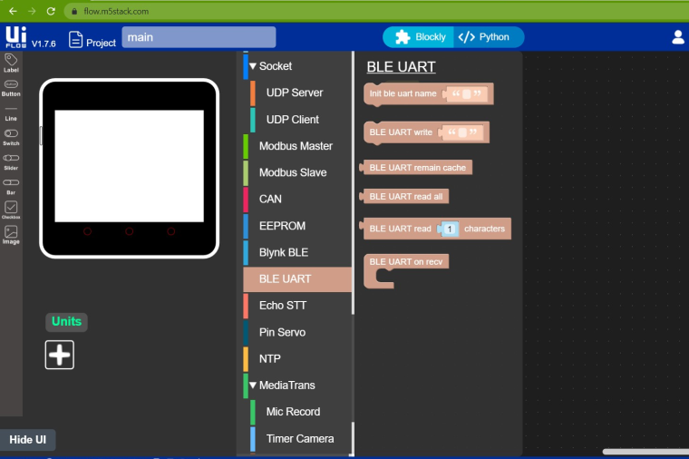

        hmm there is BLE in advance:
        B 1 Reply Last reply Reply Quote 0

          • B Offline
            benalb @OyczE
            @mati It seems it's not available for Sticks and Atoms.
            • ExieE Offline
              Exie
              On the box is says BLE ...
              alt text
              Just not implemented in the UI
