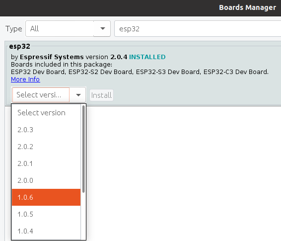

            sorry if I wasn't clear - I meant the Arduino ESP32 framework. (I've clarified my previous post.)
            The Arduino ESP32 framework is installed via the Boards Manager. Normally the latest available version is installed. But any version can be selected and up-/downgraded to.
            Please be aware that when you downgrade the Arduino ESP32 framework in the Arduino IDE, that this will affect all your ESP32 related projects, which might then fail to compile due to a too old Arduino ESP32 framework version.
