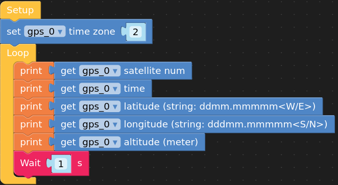

When using the EasyLoader_Atomic_GPS.exe the GPS data are transferred, it takes some time for initializing, but then it works.
Using the newest UIFlow version it does not receive any data, even after many hours outside under the sky.
Maybe my UIFlow sketch is wrong. As there is no demo, nor a documentation what must be doen to initialize the Atom GPS to make it work under UIFlow ?

it looks like ATOM GPS is broken in current UIFlow. It doesn't work for me either.
That said, I found that I can use the GPS unit blocks instead (with default custom GPIOs).
