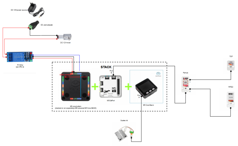

              • J Offline
                jerome83136
                hi @wsanders
                If I can drive the motor with tha Atom and H-driver; that's fine for me.
                I plan to extend it with a PaHub in order to get additional grove ports and connect the Scales kit + RFID2 reader.
                But I wonder if it will work because I'm not sure M5 Scales kit is using I2C
                I choosed the RFID2 reader because of its price (as you said: the UHF reader is quite expensive)
                I see 2 options to solve the range issue:
                • Using 3 RFID2 readers on each side of my object (see red arrows on enclosed picture)
                • Try to extend the RFID2 range with a custom antenna with magnetic wire, around the food dispenser
                • Use this cheap 125KHz RFID reader and make a custom antenna with magnetic wire, around the food dispenser. But can I make it talk to M5 stuff ? (it uses a grove connection and output format is Uart and Wiegand)
                Do you think it could work ?
                Thank you for your feedback
                Best regards

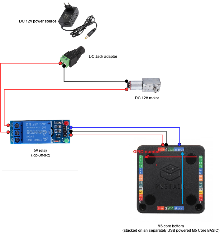

                    For the 12v DC motor control; I have some troubles.
                    I ordered a GoPlus2; but it tidn't feet because even if it has a 12v input; it can't deliver 12v output to my DC motor.
                    So I switched to another option: using a 5v relay to power the 12v DC motor.
                    The problem I have is: how to use the M5 Core to control the 5v relay ?
                    I tried this example but I'm just unable to understand what are the pins used by this guy on the M5 core ?
                    The guy uses the pins 2, 27, 32 and 13; but where are these pins on the M5 core basic I own ?
                    Do I have to remove the M5 core bottom (received with the M5 core basic) ?
                    I don't really understad the pin map of the M5 core basic. Is there some reference somewhere for wiring ? And is there a description about the colours used on the M5 core basic product sheet pinmap section ?
                    Or some example telling "if you are using digitalWrite(2, 0) on UIFlow; you have to use this specific pin on the core"
                    Best regards
                    • ajb2k3A Offline
                      ajb2k3
                      The pinouts are located on the M5Stack product page by following the documents link https://docs.m5stack.com/en/core/basic_v2.6?ref=pfpqkvphmgr
                      The exact pins and location depend on the specific model of core but he is using the Core2's MBus which is the big internal connector.
                      • J Offline
                        jerome83136
                        Hello,
                        Thank you for your feedback.

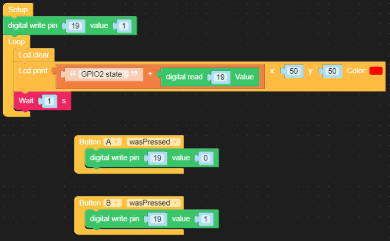

                        As I'm quite new on this kind of stuff (using pins to interact with an external component); I need some tips :)
                        When I do this on UIFlow:
                        I understand it activates the pin n°2 (LOW), when the "switch0" is activated. Am I right ?
                        How can I identify the pin n°2 on my M5 Core basic with a base core bottom ?
                        I think I need some documentation/tutorial to understand the correspondance between the pins used into UIFlow and the the pinmap on M5 Core Basic. Can I find this somewhere ?
                        Thank you for your help
                        Best regards
                        • J Offline
                          jerome83136
                          Hi,
                          I finally got the relay working with M5 Core Basic !
                          I think my mistake was to power the relay with 5v rather than 3.3v
                          Here is my wiring:
                          And here is the example UIFlow that works for me:

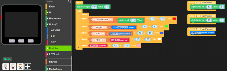

                          • J Offline
                            jerome83136
                            Hi all,
                            Another report here.
                            Almost everything is ready.
                            I'm quite sure the RFID2 reader won't do the job because of its short reading range; let's try and improve if required.
                            I will certainly have to give this reader a try. (already ordered)
                            1 question I had while testing: TOF and RFID2 seems to need Ports A or E. But Port E never worked (the unit is seen as "not connected" by the Core); forcing me to use a PaHub which is a pity because I have plenty of available ports with the ExtPort extension.
                            Someone able to help me understanding why ? (If I could use port E; I could completely remove the PaHub)
                            Here is the current setup:
                            Last thing to do to complete the prototype: get a 12v --> 5V USB connector in order to power the M5 Core + 12v DC motor with a single source.
                            Here is a simple UIFlow to check every component works correctly:
                            Best regards

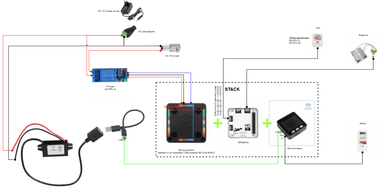

                            • J Offline
                              jerome83136
                              Hello all,
                              Last part done (single power supply for M5 core + DC motor)
                              I was also able to remove the PaHub by using the ExtPort (Port D). I had to change the dip switch value to:
                              • Port D-1[2] = ON (to use GPIO22)
                              • Port D-2[2] = ON (to use GPIO21)
                              I then had to change the TOF module's port config in UIFlow to use the Port D:
                              Final diagram:
                              NB: DC(12v) to USB(5v) converter link
                              Now let's get physcal parts printed and test it !
                              Best regards

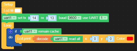

                                  New problem here: I'm unable to use this RFID reader from Seeed studio
                                  The reader is able to communicate by serial (9600 baudrate, 8 data bits, 1 stop bit, and no verify bit)
                                  I connected it with my Ext port Blue port PortC (stacked with my M5 Core Basic)
                                  • Reader Yellow wire (TX) --> Ext port (Port C) / PIN13
                                  • Reader White wire (RX) --> Ext port (Port C) / PIN14
                                  On UI Flow I tried this:
                                  When I put an RFID tag on the reader; a red led seems to indicate it detects the tag; but I get nothing printed on my M5 Core Basic screen.
                                  What did I wong ?
                                  Best regards

                                      • ajb2k3A Offline
                                        ajb2k3
                                        Have you got a micropython library installed for the reader?
                                        It looks like you set up the connection but you have yet to initialise the reader and tell it to start talking.
                                        • J Offline
                                          jerome83136

                                          • J Offline
                                            jerome83136

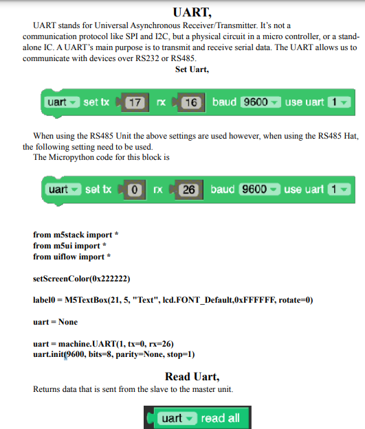

                                            Hello @ajb2k3
                                            I took a look on your UIFlow handbook for some examples on serial communication.
                                            I found this:
                                            It seems the code is almost the same than the one generated for me by UIFlow.
                                            The imported libraries are the same than the ones I have in my code:
                                            from m5stack import
                                            from m5ui import
                                            from uiflow import
                                            On the example provided by my reader's provider; they import this library: " #include <SoftwareSerial.h>"
                                            https://wiki.seeedstudio.com/Grove-125KHz_RFID_Reader/#play-with-arduino
                                            But I think this is the implémentation for Arduino and I guess the equivalent UIFlow libraries are loaded through this:
                                            from m5stack import
                                            from m5ui import
                                            from uiflow import
                                            Do I miss something ?
                                            On my side I think the reader works because when I bring a RFID tag close to it; the status led of the reader lights up.
                                            But I still receive nothing on the M5 core RX PIN
