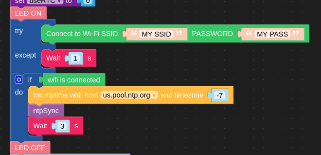

UIFlow: How to try/except for "Connect to Wifi"?
I am trying to get the program to ignore failure to connect to WiFi. I tried to place a Wifi Connect block inside a try/except (with a bogus SSID/password):

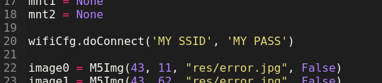

Instead, the program hangs, before the LED comes on, because the python that gets generated places the wifiCfg.doConnect up at the top of the program (line 20):
and the try/except block is empty, much later in the program at line 87:
Is there a way to create an exception for WiFi failure to connect?
I also notice that UIFlow does not have a "pass" block. I just put a wait() in mine - ???

RE: UIFlow: How to try/except for "Connect to Wifi"?
@wsanders SOLUTION: Use "Original Network Function" blocks instead.

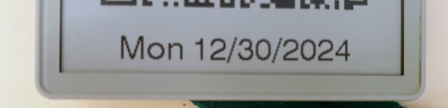

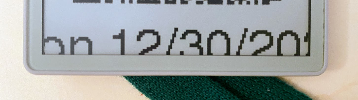

Solution: Getting decent looking fonts on PaperS3
I'm trying to get decent-looking fonts on the PaperS3. As called by setFont, the fonts are huge and blocky (unaliased). However, If they are subsequently scaled by setTextSize, even wth a scale of 1.0, they are the right size and smooth.
You have to experiment. For example, with Font6 and Font8, punctuation charactersaren't rendered, I am guessing to save space. But Font4 scaled up to 2.0 looks very nice.
I've attached a couple of images that show this effect:
M5.Display.setFont(&fonts::Font4), without scaling:
M5.Display.setFont(&fonts::Font4);
M5.Display.setTextSize(2.0);
Not sure if this is a bug or a feature, but it works!
