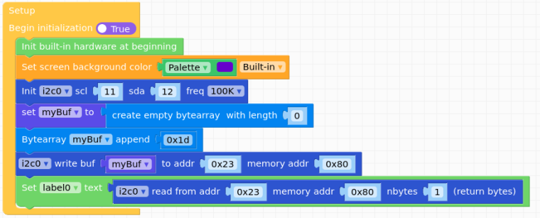

3: I am able to write to and read from the light sensor like below:
Thanks
Felix -
