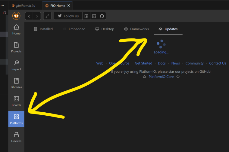

                  Hi, this issue was solved. Easy and logical way:
                  VScode > PlantformIO home > plantforms > update
