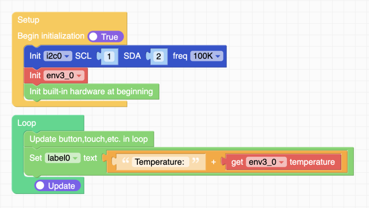

            • ajb2k3A Offline
              ajb2k3
              I see you issue, you have everything in setup when it should be in loop.
              You code should be like this:
