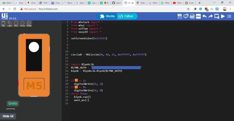

      If it doesn’t understand that line it may not have imported the library correctly. Did you put it in the /flash/lib directory on the m5stack? Also, just wanted to make sure you are running the latest v1.1.2 firmware.
      Did you paste your Blynk Auth Key into the flow before running it in uiFlow?
      Also, are you able to access the REPL prompt? If not I can show you how. It’s good for troubleshooting.
      • L Offline
        LastCaress
        I am running the latest firmware and I uploaded the BlynkLib.py file from the git repo you linked using rshell to /flash/lib :P I used a raspbian os to it as I've never been able to use ampy! The import BlynkLib line of code doesn't cause any error. I did paste the auth key :D
        I do not know how to access the repl prompt though!
        • L Offline
          LastCaress
          So I got hold of a macbook and tried via ampy and.. it works!! I should've tried this before as my attemps at using the blynk python library probably didn't work before because I used rshell and maybe it sends the file in a different format? This is very nice!

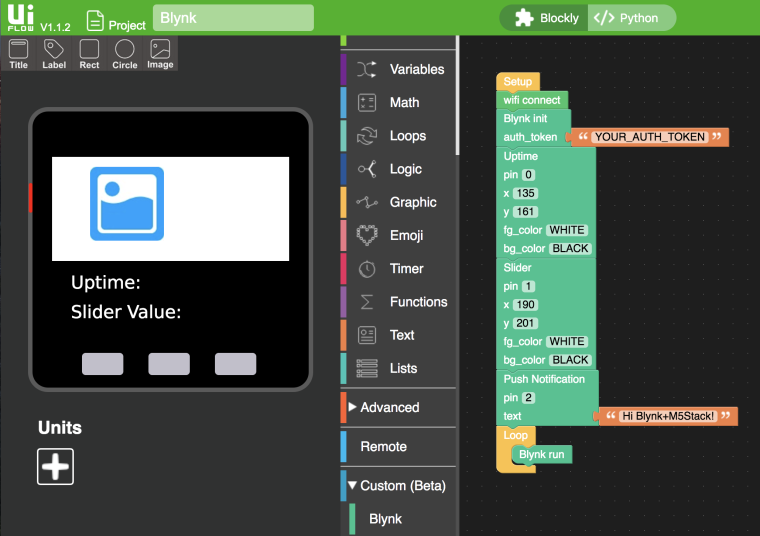

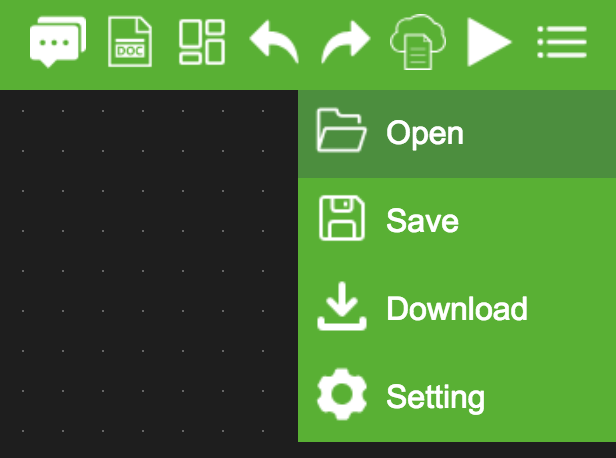

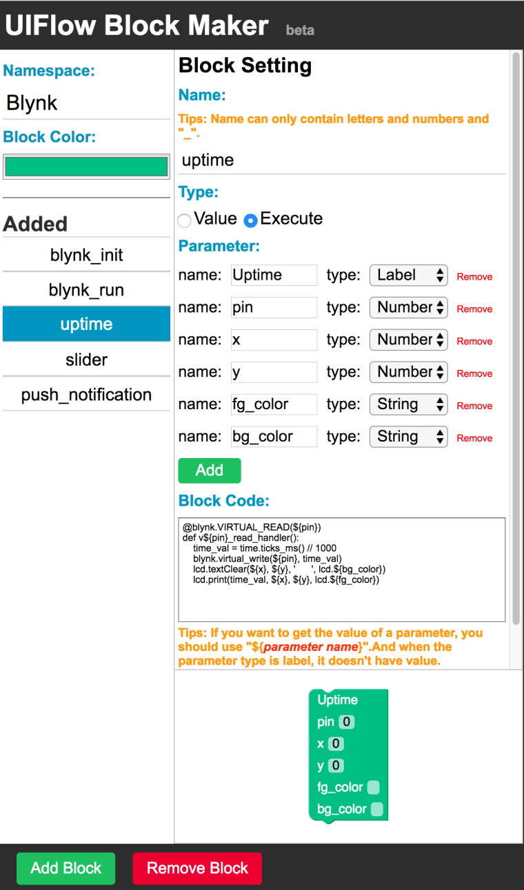

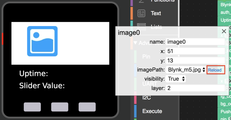

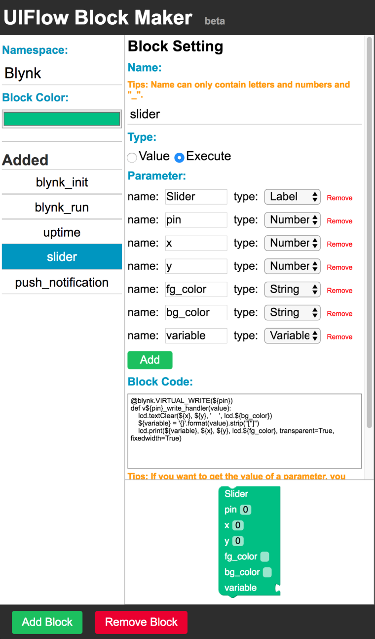

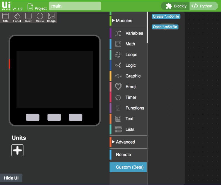

                  By the way, I haven't found a way to import existing m5b files into block-maker.m5stack.com, so here are the ones I created. Feel free to play around with them and even create some new ones! The official Blynk colors are here: http://docs.blynk.cc/#blynk-main-operations-change-widget-properties

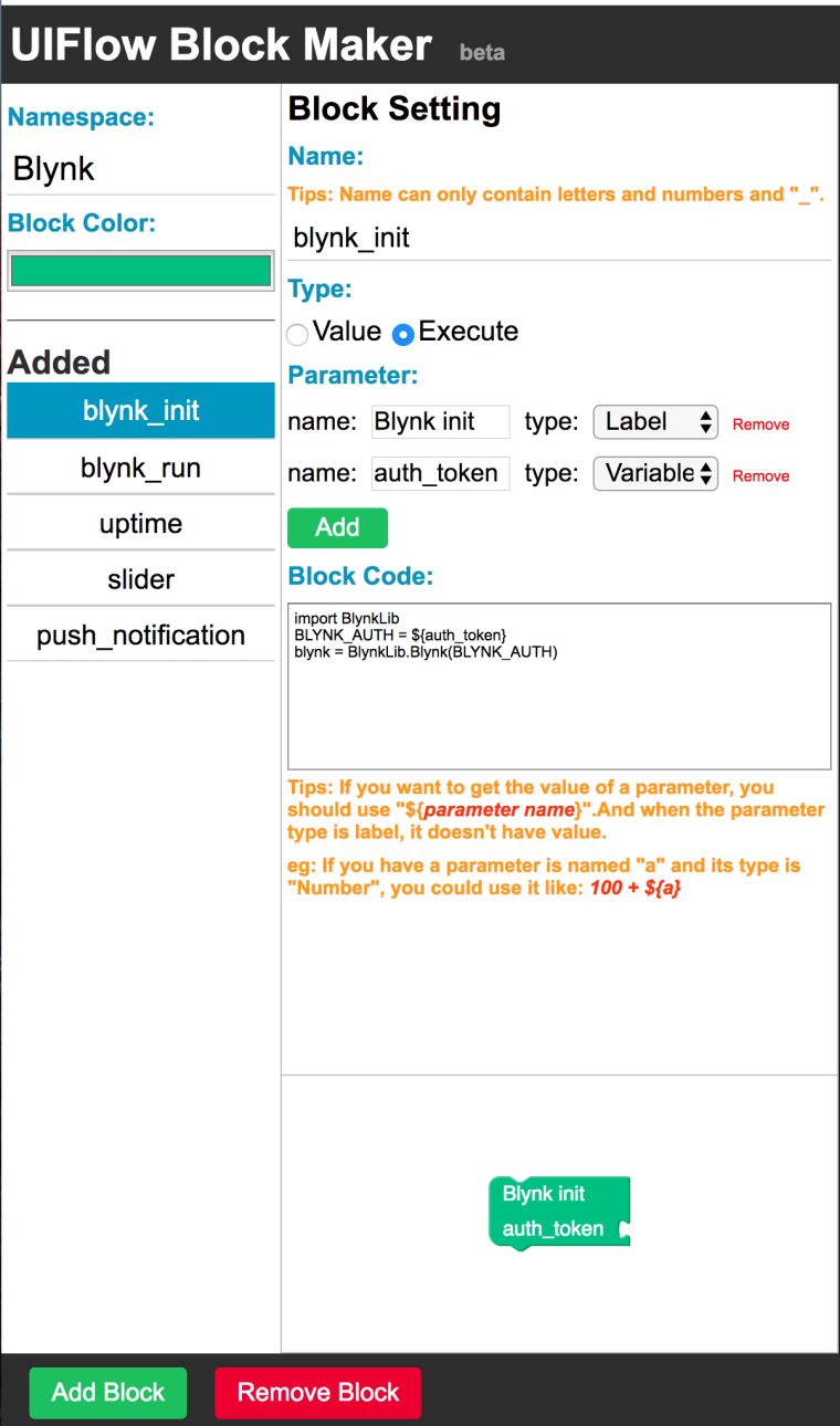

                  Blynk Init:
                  import BlynkLib
                  BLYNK_AUTH = ${auth_token}
                  blynk = BlynkLib.Blynk(BLYNK_AUTH)

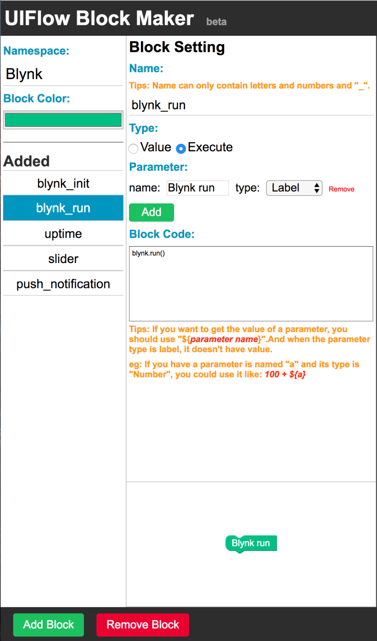

                  Blynk Run:
                  blynk.run()

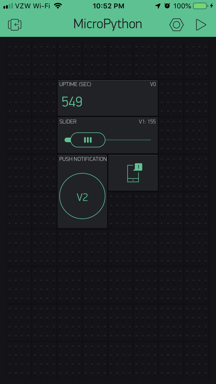

                  Uptime:
                  @blynk.VIRTUAL_READ(${pin})
                  def v${pin}_read_handler():
                      time_val = time.ticks_ms() // 1000
                      blynk.virtual_write(${pin}, time_val)
                      lcd.textClear(${x}, ${y}, '      ', lcd.${bg_color})
                      lcd.print(time_val, ${x}, ${y}, lcd.${fg_color})

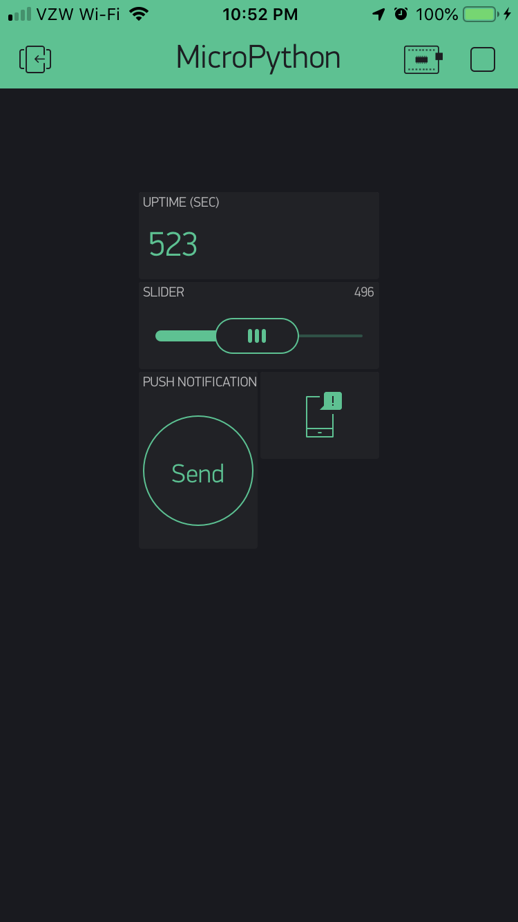

                  Slider: (Note, this is slightly different than the tutorial above. I was experimenting with passing a variable into the block. Feel free to adjust it as needed)
                  @blynk.VIRTUAL_WRITE(${pin})
                  def v${pin}_write_handler(value):
                      ${variable} = '{}'.format(value).strip("['']")
                      lcd.print(${variable}, ${x}, ${y}, lcd.${fg_color}, transparent=True, fixedwidth=True)

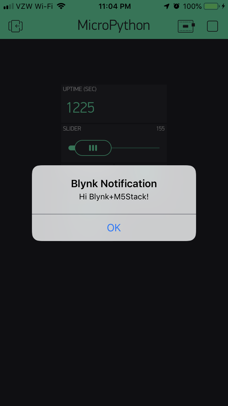

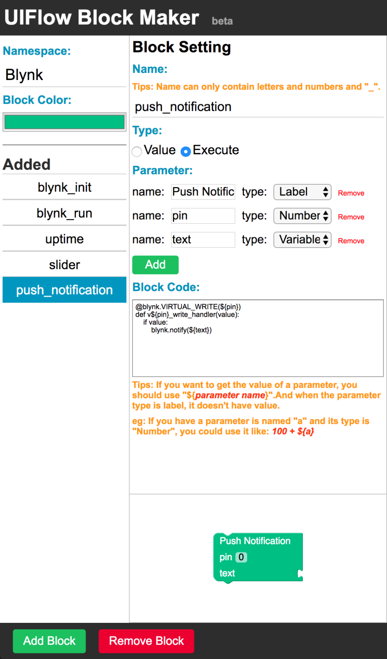

                  Push Notification:
                      if value:
                          blynk.notify(${text})

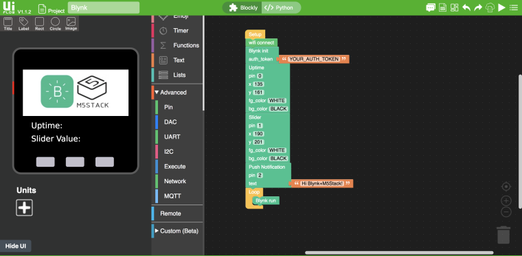

                  I'm really interested in how to link blocks together, like the m5stack team did for the MQTT blocks. But I'll start a new thread on that soon.

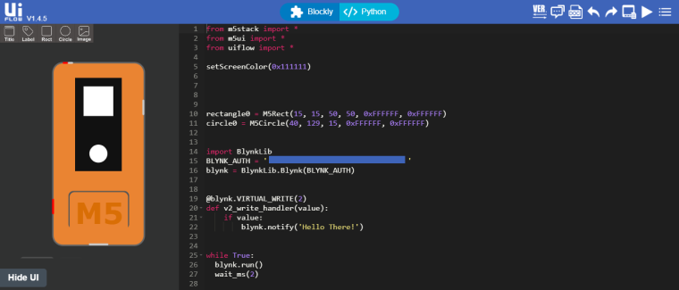

                                      Hi! I'm a complete beginner learning to use stickC, I managed to figure out Blynk with Arduino, but now, I'd like to do it with uiflow.
                                      Since I have the latest versions of both (blynk.py - 0.2.6 & uiflow - 1.4.5.1), I wanted to know if the procedure is still the same. Also, if there are other reference links/good material to learn about esp32 with python, then do share!
                                      I'm an industrial design student trying to make a battery-powered heated lunchbox for my thesis, which I'd like to control with the phone and also show nice graphics using stickC.
                                      Any help appreciated!
                                      Thank you :)
                                      A 1 Reply Last reply Reply Quote 0
                                      • A Offline
                                        akshaypatil @akshaypatil
                                        @akshaypatil said in Blynk on M5Stack via uiFlow and block-maker:
                                        Thank you :)
                                        Alright!
                                        I figured how to upload and run the BlynkLib 0.2.0 on uiflow - 1.4.5. :D
                                        The device is successfully detected and shown running on the android app.
                                        Now, I only need to figure how to control/toggle GPIO pins through uiflow with Blynk. :)
                                        Any tips? :P
                                        P.S.
                                        The push notification is not working. Is this limited to M5Stack only? Or also possible on my device...
