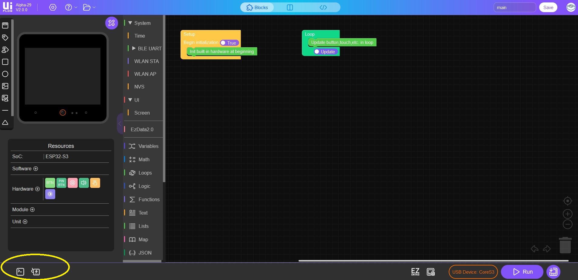

                                        have you tried Uiflow2 web burner option with "boot press"? bottom left corner
                                        (![0_1706622355894_uiflowburner.jpg](Uploading 100%) image url)

                                          HankTTTop
                                          I didn't know about this application. I just tested it, but it doesn't connect either.
                                          robskiR 1 Reply Last reply Reply Quote 0
