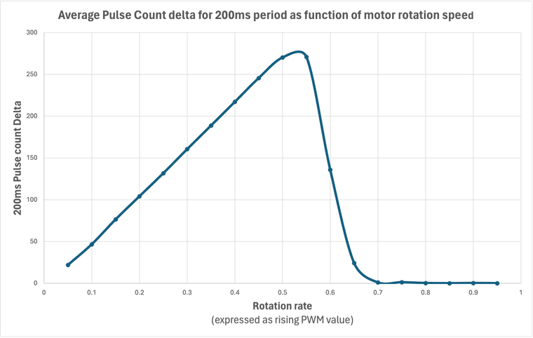

                      I need to connect an encoder to a Raspberry Pi and noted the M5Stack EXT-ENCODER (U161) appeared to offer exactly what I needed. However, initial testing identified a couple of issues.
                      Two test rigs were used - both gave similar results. The first used a commercially available encoder rated at 1600 pulses / round (quadrature) and max rotation rate of 5000 rpm. For the first test, the encoder shaft was rotated by a motor driven friction wheel. The second encoder was a hobbyist unit pre-mounted on a small motor. In both cases the A/B encoder and power connections went to the M5Stack EXT-ENCODER which was further connected to the Raspberry Pi GPIO header as per specifications. No additional pull up/down resistors were added as my reading of the device spec was that these were provided internally by the EXT-ENCODER where required.
                      The test was run multiple times each driving the motor at higher rotation rates via increased PWM values. Each run was over a period of 20 seconds with the EXT-ENCODER pulse value sampled over the I2C bus every 200ms. The difference between the latest and previous count value was recorded.
                      The encoder values were computed as per the M5Stack documentation from the 4 bytes pulled from the I2C port 0x59 Register 0x10
                      The graph below plots the average change in pulse value for 200ms samples at each motor speed.
                      As expected, the value returned by the EXT-ENCODER increases as the motor rotation rate rises. However it reaches a point where increased motor speed results in no further rise in the value returned by the EXT-ENCODER and instead starts to drop. Any further increases in motor speed result in the device reporting the same value repeatedly. I should add these rotation rates were fairly low.
                      I’m wondering if this means the rate at which the encoders were generating pulses exceeded the EXT-ENCODER’s ability to ‘catch’ them.
                      So my question is - what is the practical maximum pulse rate the EXT-ENCODER’s STM32F030 microcontroller can sustain and still reliably report it over the I2C bus? I’m using the SMBUS package for this.
                      I’ve tried both increasing and decreasing the I2C bus speed on the Raspberry Pi but this made no difference.
                      Another observation during these tests was that the EXT-ENCODER would very occasionally show an unexpected and sudden change in the encoder count value returned from the EXT-ENCODER. The EXT-ENCODER holds the pulse count as an unsigned 32bit integer and can be shown to accumulate counts up to the max value of 4294967295 before wrapping round back to zero (the converse happening for rotation in the opposite direction). However, these random flips of the returned count were obviously happening in the EXT-ENCODER as subsequent I2C calls continued to return values rising from the
