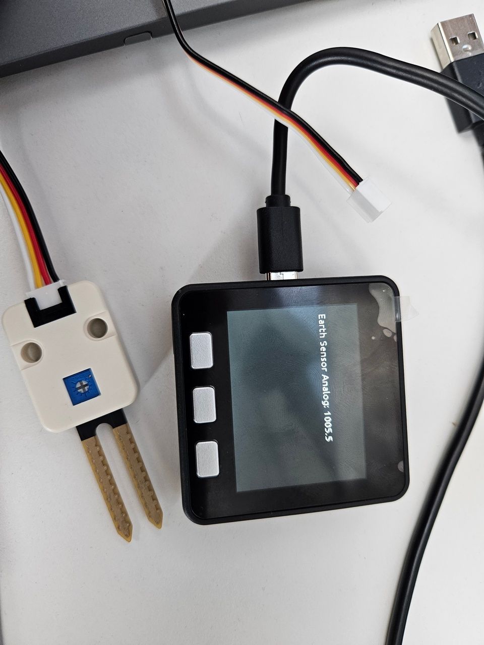

      Update: The readings do not change even when I completely unplug the sensor. The display still gives me similar values above 1000. Thus, it somehow seems as of the sensor might not be providing any data at all? It makes no difference whether or not the sensor is attached to the device. 20240522_171840.jpg

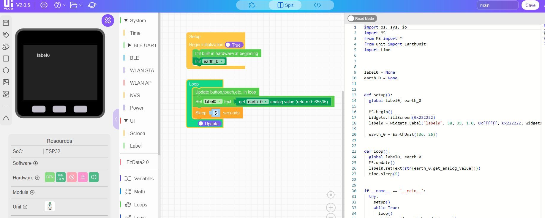

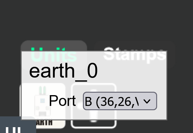

                    @rudi15 said in Earth sensor:
                    And just for the sake of completeness: The sensor is on Port B.

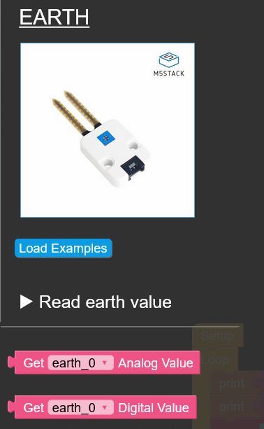

                    is example which you can load from Earth unit section works?

                      rudi15 @robski
                      @robski generally yes. I can see these examples in UI Flow and I did use them when building the code.

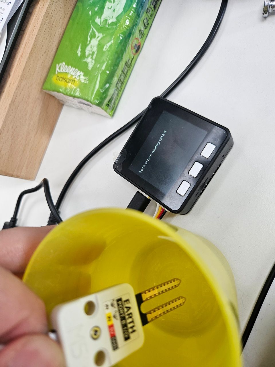

                        Hello,
                        I am a newbie to M5stack and want to use the Earth sensor to display moisture values. I followed the instructions as outlined in this video by exactly rebuilding the respective code: https://www.youtube.com/watch?v=rYi8XLe3X_c
                        The device now does show data, but it is constantly above 1000 even when just laying on my desk without any contact to water (up to the maximum of 1024 which, as far as I understand, indicates that the sensor detects water (fully wet)). When I put the senor into water, the readings do not change they stay above 1000.
                        Any idea what I did wrong?
                        It wont work as the RED Port is PortA I2C, you need to connect it to a Black Port B or use a PBhub to convert to I2C
