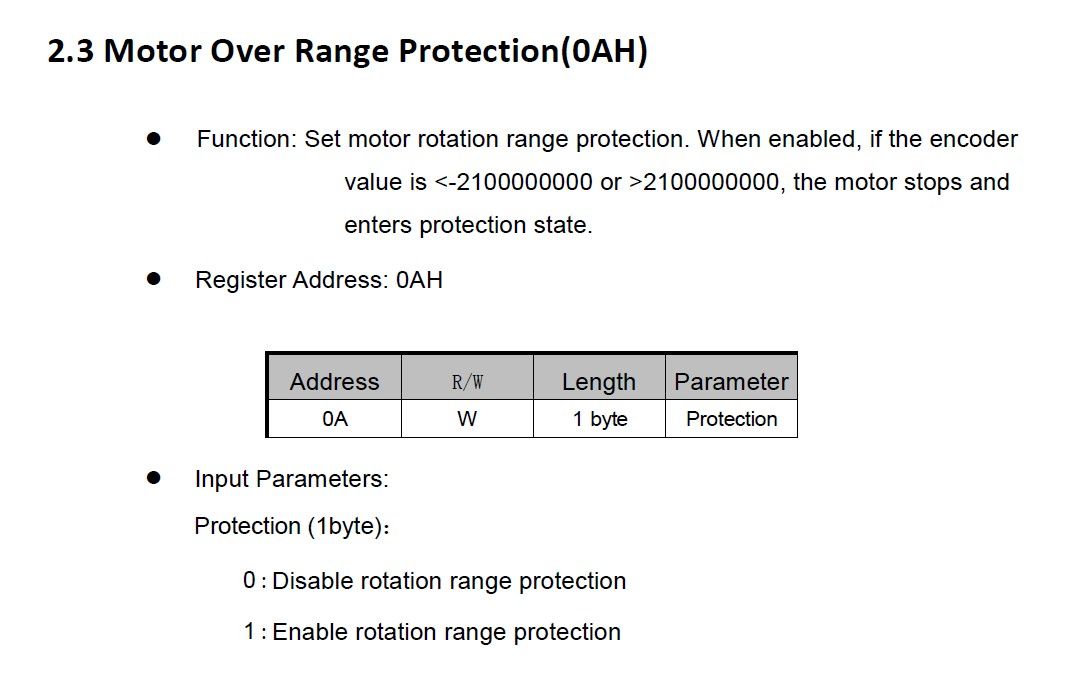

Can you still communicate with the Roller? Then you can disable the Motor Over Range Protection.
If this doesn't work and you restart (disconnect the motor and the controller for at least 1 minute) and the motor isn't blocked, you can try manually turning it back. If the motor is blocked, you can try lowering the current or voltage so that the motor loses power while the electronics continue to function.
