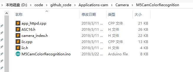

            Yes, Color recognition arduino program may help you.
            Here's the code:
            https://github.com/m5stack/Applications-cam/blob/master/Camera/M5CamColorRecognition/M5CamColorRecognition.ino#L36

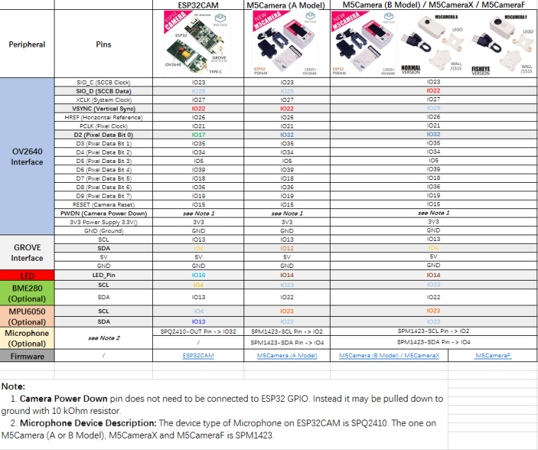

                You need chang this source code about camera hardware configuration for adapting to ESP32CAM. Because the arduino source code is for M5Camera A model.
                // Select camera model
                //#define CAMERA_MODEL_WROVER_KIT
                #define CAMERA_A_MODEL_M5STACK_PSRAM
                //#define CAMERA_MODEL_AI_THINKER
                https://docs.m5stack.com/#/en/unit/esp32cam

                      @gachapo Do you modify those pin map for adapting to ESP32CAM not M5Camera (A model)?
                      https://github.com/m5stack/Applications-cam/blob/master/Camera/M5CamColorRecognition/M5CamColorRecognition.ino#L62
                      #elif defined(CAMERA_A_MODEL_M5STACK_PSRAM)
                      #define PWDN_GPIO_NUM     -1
                      #define RESET_GPIO_NUM    15
                      #define XCLK_GPIO_NUM     27
                      #define SIOD_GPIO_NUM     25
                      #define SIOC_GPIO_NUM     23
                      #define Y9_GPIO_NUM       19
                      #define Y8_GPIO_NUM       36
                      #define Y7_GPIO_NUM       18
                      #define Y6_GPIO_NUM       39
                      #define Y5_GPIO_NUM        5
                      #define Y4_GPIO_NUM       34
                      #define Y3_GPIO_NUM       35
                      #define Y2_GPIO_NUM       32
                      #define VSYNC_GPIO_NUM    22
                      #define HREF_GPIO_NUM     26
                      #define PCLK_GPIO_NUM     21

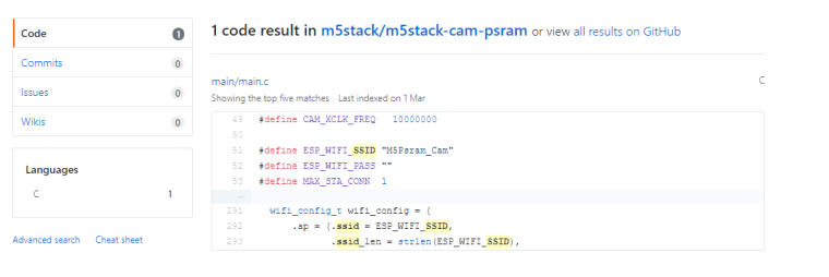

                          https://github.com/m5stack/m5stack-cam-psram/tree/NoPsram

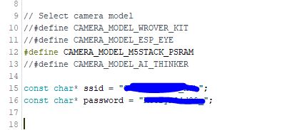

                                  @watson Ok - so frustrated was I with my first attempt I purchased a M5Camera ESP32 PSRAM. Works out of the box nicely, but only on it's own wifi (192.168.4.1). However, as previously I need to get onto my network.
                                  Therefore, using Arduino IDE I have gone to File, Examples, ESP32, Camera nd loaded up the sketch from there.
                                  I have then amended the SSID and Password to my own and defined the PSRAM camera as below;
                                  Compiles and uploaded the sketch.
                                  Nothing! - Camera doesn't even turn on.
                                  Can somebody please, simply tell me where I am going wrong and how you ever get this great product on your own network.
                                  Thanks

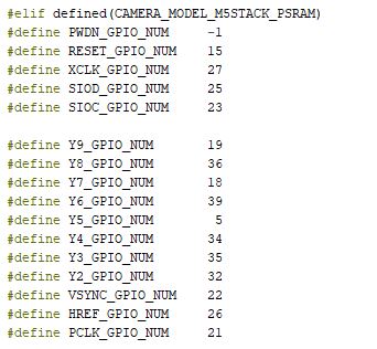

                                    Oyye @GACHAPO
                                    @gachapo
                                    I just registered for you :D
                                    Here what is solved my problem (Y2_GPIO_NUM):
                                    #elif defined(CAMERA_MODEL_M5STACK_PSRAM)
                                    #define Y2_GPIO_NUM 17 //32
                                    ajb2k3A G 2 Replies Last reply Reply Quote 0

                                        GACHAPO @Oyye
                                        @oyye Thank-you,
                                        I did as you stated with only change from the Arduino Examples being;
                                        This has made no change - Camera still does not come on.
