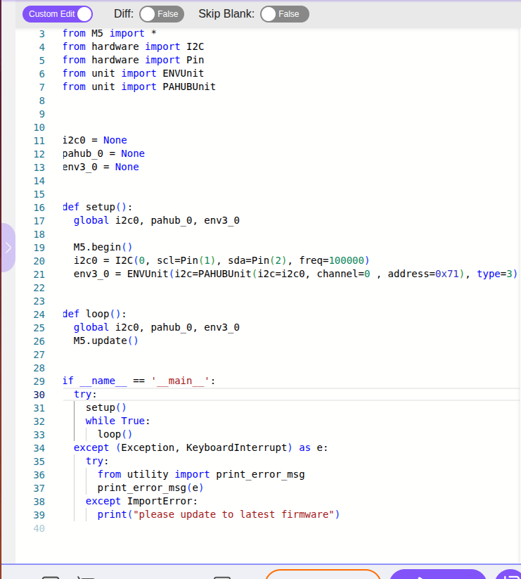

RE: PaHub v2.1 Doesn't recognise ENV III Unit
@felmue Finally got it working correctly. In addition to your code, I initialised the Pahub, and then changed the dip switch to 0x71. Additional units work fine when assigned to 0x71.
Thanks for the help! -
@felmue I followed the instructions, and am getting this result"
File "<stdin>", line 21, in <module>
File "<stdin>", line 15, in setup
File "unit/env.py", line 41, in init
File "driver/qmp6988.py", line 99, in init
File "unit/pahub.py", line 100, in readfrom_mem
File "unit/pahub.py", line 37, in select_channel
OSError: [Errno 19] ENODEVHere is the relevant code
