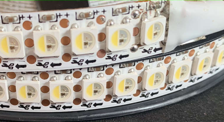

its have still 3 wire- but 4 channels every LED, so if you counter - need to set the numbers of channels to 4 instead of 3 for RGB

its a true 4channel IC, I use this for a high power brightness, the 4. channel is the Warmwhite or cold white, now I need to set to 4 channels each LED
SK6812 RGBW
Is there any option to use a 4color led on the M5 Stack ?
I need as a Test-Device for installations
