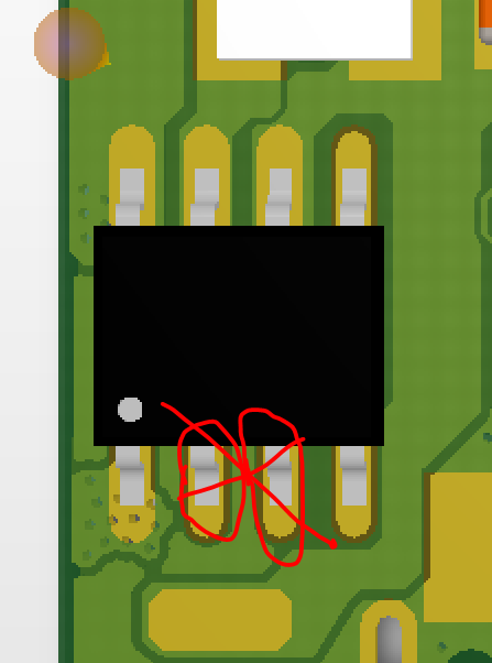

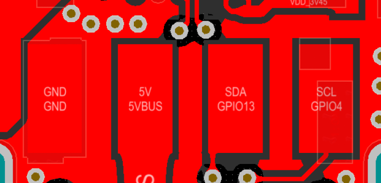

hello, the old camera version's IP5306 maybe connect to I2C, maybe confused. so if u need to use I2C, you should cut the sda/scl pin
of IP5306.
