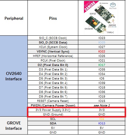

@m5-docs Thanks for reply! I use #define CAMERA_MODEL_M5STACK_PSRAM with changed settings and it works for me. Complaints about the picture and streaming video in the browser I do not have. I powered the battery through the GROVE connector where using the step-up. The Board is now fed 5 volts and it works, it turns on, no problem. But according to the documentation the Board can work directly from 3.3 V using two pins next to the GROVE connector but for me it does not work, the Board is not included. I use charge ESP32CAM and indicated that she M5Stack what would You have her confused with CAMERA_MODEL_ROVER_KIT . By the way this motherboard I have and it works on 3.3 V if the pins apply power, only works shockingly bad))))

Hi! Has anyone tried running the camera on battery power? I use the firmware from the Arduino camera examples works well though I had to edit the code. I soldered two wires to the outputs near the GROVE connector and connected the 18650 battery there, but the camera did not want to work with it, I also tried on the LI-POL battery but I did not work out. The most interesting that I immediately bought two boards M5Stack ESP32CAM and neither works on battery. The output voltage is 4.2 V well as with any battery. In advance thanks!!!
