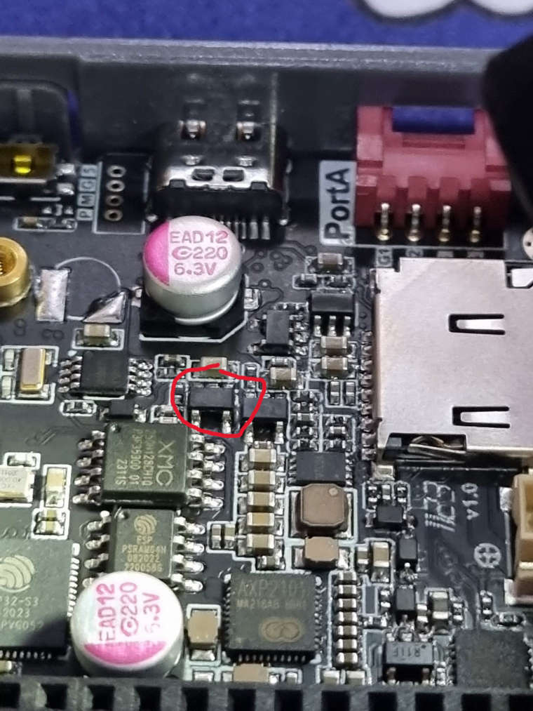

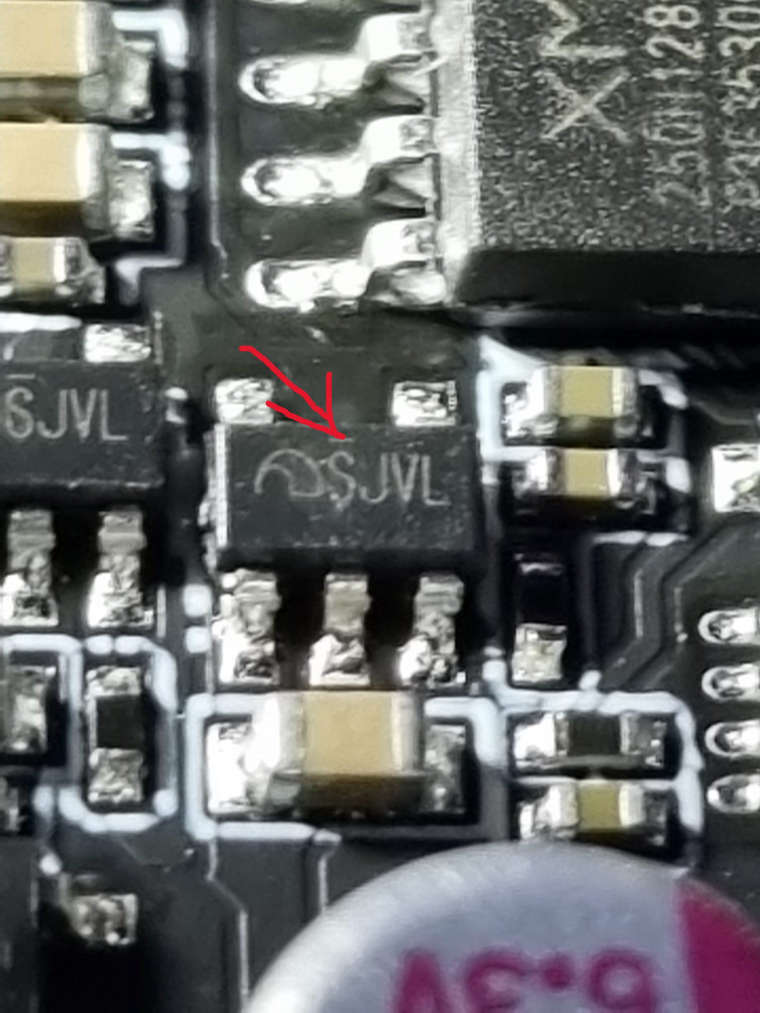

@felmue
I have opened up my unit further and, with some thermal probing, found that the highlighted chip gets to 70 degree and seems to be where the short is. I know that my unit is pretty much dead with this short. I just wonder if anyone know what this SJVL chip is as google failed to gives me any hint.

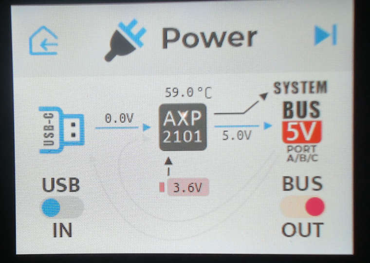

Please see the demo program images to better illustrate what I observe. This is just the core s3 with demo program without anything else attached/connected.
M5 CoreS3 power drain issue.
My M5 CoreS3 develops an issue that the battery drains within half an hour from full and it heats up a lot. I has been programming with it together with a gps module and then a gps unit with no issue for about two weeks. I revert to demo program and disconnect all peripherals and the issue persists. I use the power options in the demo program and find that with bus out on the unit heat up to 60 degree and with bus out off the unit cool down to 40 degree. Any suggestion how I can troubleshoot this further?
