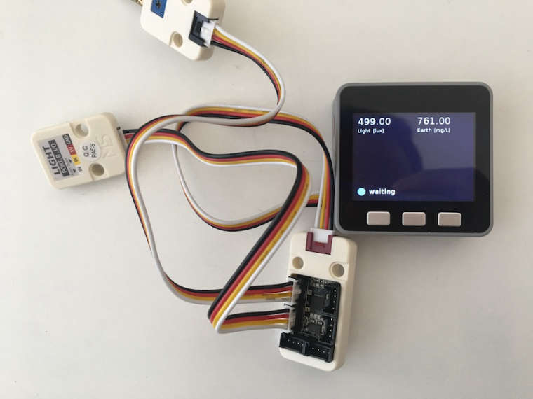

self.adc.readraw()it will output decreasing values. This inversion is missing when reading directly fromPbHUB.class Light: @staticmethod def analogValue(value): data = 0 max = 0 min = 4096 for i in range(0, 10): newdata = 4095 - value data += newdata if newdata > max: max = newdata if newdata < min: min = newdata data -= (max + min) data >>= 3 return round(1024 * data / 4095, 2) print(400, Light.analogValue(400)) # 400 923.98 print(500, Light.analogValue(500)) # 500 898.97 print(600, Light.analogValue(600)) # 600 873.96 print(700, Light.analogValue(700)) # 700 848.96 print(800, Light.analogValue(800)) # 800 823.95 print(900, Light.analogValue(900)) # 900 798.95 -
RE: Connect units to PbHUB
@lukasmaximus @ajb2k3 Thanks for your support! Although the video does not really answer my question.
I am able to read values from the PbHUB like this:
pbhub = unit.get(unit.PBHUB, unit.PORTA) earth = pbhub.analogRead(0x00) light = pbhub.analogRead(0x01)The problem is, that these values seem to be wrong. The lux value increases when it gets darker, similarly the earth unit says the earth gets dryer when it actually gets wetter. I think the problem is, that reading directly from
PbHUB, the logic from theLIGHT.analogValuefunction is missing:class Light: @property def analogValue(self): data = 0 max = 0 min = 4096 for i in range(0, 10): newdata = 4095 - self.adc.readraw() data += newdata if newdata > max: max = newdata if newdata < min: min = newdata data -= (max + min) data >>= 3 return round(1024 * data / 4095, 2)This function seems to transform the data in a way that is missing when reading the value directly from
PbHUB. My question is whether I do have to copy paste this logic or whether there is some way to reuse theLIGHTunit withPbHUB?I would like to be able to do something like this:
pbhub = unit.get(unit.PBHUB, unit.PORTA) earth = unit.get(unit.EARTH, pbhub.HUB0) # Not M5Stack API yet light = unit.get(unit.LIGHT, pbhub.HUB1) # Not M5Stack API yet # This should read the value correctly, using the `LIGHT.analogValue` logic print(earth.analogValue()) print(light.analogValue()) -
I am trying to connect a
LIGHTand anEARTHunit to thePbHUB. I connected thePbHUBtoPortA, theEARTHsensor toHub 0and theLIGHTsensor toHub 1.
My code looks like this:
pbhub = unit.get(unit.PBHUB, unit.PORTA) earth = pbhub.analogRead(0x00) light = pbhub.analogRead(0x01)I am able to read values from both sensors, however with strange behaviours. E.g. the lux value increases when it gets darker and vice versa. I guess the problem is, that I am lacking the logic of the
analogReadfunction in theLIGHTandEARTHunits:
https://github.com/m5stack/UIFlow-Code/blob/a0dbef98fe29323d6b1837b479764fdab50c3836/units/_light.py
https://github.com/m5stack/UIFlow-Code/blob/a0dbef98fe29323d6b1837b479764fdab50c3836/units/_earth.pyHowever I do not see how I would have to connect this unit correctly to the
PbHUB. Do I have to copy paste theanalogReadlogic or is there another way to connect these units?
@ajb2k3 Do you know how this should be handled? -
