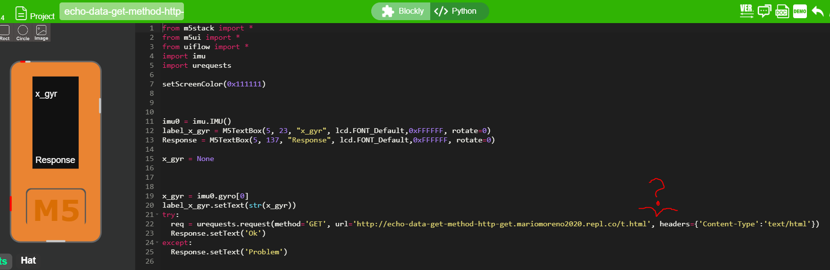

@uecken Replace the text box containing the URL with an unescaped text box. That way, the URL won't get truncated. See also this post: HTTP GET query parameters
