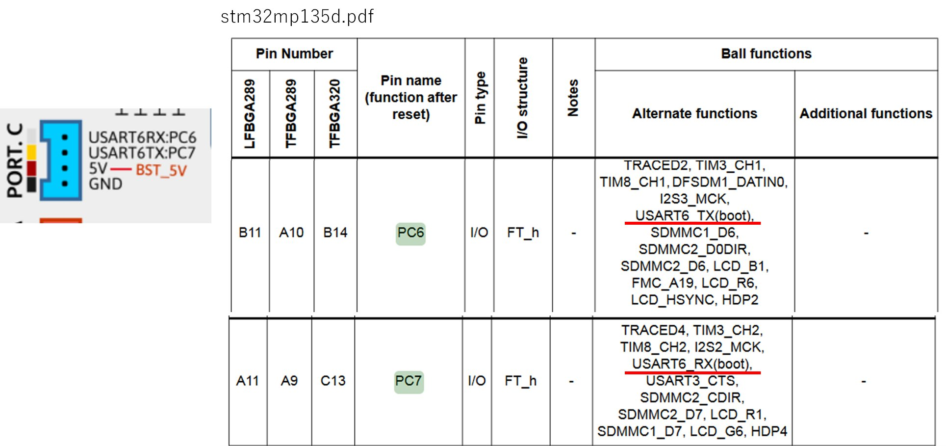

According to the data sheet, is the IO of UART6 fixed at startup?
Reference:
https://www.st.com/ja/microcontrollers-microprocessors/stm32mp135d.html -

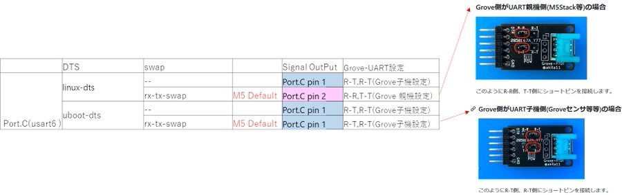

RE: Port.C of boot serial console is IO inverted on CoreMP135.
The uart6 in linux-dts was able to switch IO with rx-tx-swap.
The uart6 in uboot-dts seems to be fixed, unable to switch IO with rx-tx-swap.
Is there a HW issue with the Stm32MP135?
The boot serial console can be accessed from Grove Port.C on the CoreMP135, via USB serial.
U-Boot logs are output from Port.C pin 1 (non TX-RX swap signal), while the Linux console is output from Port.C pin 2 (with TX-RX swap signal).
I would like to see the U-Boot logs and Linux console aligned on the same IO.

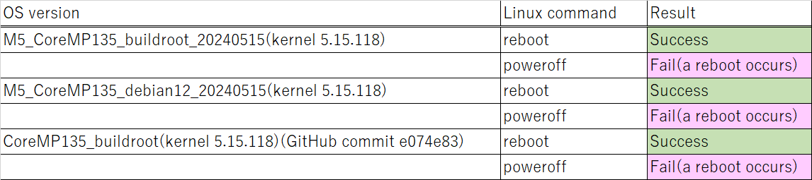

Poweroff command is Fail on M5CoreMP135.
On M5 CoreMP135, the "poweroff" command does not shutdown properly. After some time, a reboot occurs.
The "reboot" command works correctly.
There is no difference between buildroot and Debian, and the same phenomenon occurs in the latest commit of buildroot on github.
Linux Log(USB serial connected to CoreMP135 Port.C, Log in root)
$ poweroff Stopping /etc/rc.localOK Stopping dropbear sshd: OK Stopping dhcpcd... stopped /sbin/dhcpcd (pid 177) Stopping network: OK Stopping tee-supplicant: FAIL Seeding 256 bits and crediting Saving 256 bits of creditable seed for next boot Stopping mdev... stopped process in pidfile '/var/run/mdev.pid' (pid 138) OK Stopping modules: rmmod: can't unload module 'soundcore': Resource temporarily unavailable rmmod: can't unload module 'snd': Resource temporarily unavailable rmmod: can't unload module 'snd_timer': Resource temporarily unavailable rmmod: can't unload module 'snd_pcm': Resource temporarily unavailable rmmod: can't unload module 'snd_pcm_dmaengine': Resource temporarily unavailable rmmod: can't unload module 'snd_soc_core': Resource temporarily unavailable rmmod: can't unload module 'snd_soc_simple_card_utils': Resource temporarily unavailable rmmod: can't unload module 'libcomposite': Resource temporarily unavailable OK Stopping klogd: OK Stopping syslogd: OK umount: devtmpfs busy - remounted read-only The system is going down NOW! Sent SIGTERM to all processes Sent SIGKILL to all processes Requesting system poweroff [ 235.243319] reboot: Power down E/TC:0 Panic at core/arch/arm/plat-stm32mp1/pm/low_power.c:405 <stm32_enter_cstop_shutdown> E/TC:0 TEE load address @ 0xde200000 E/TC:0 Call stack: E/TC:0 0xde203f29 E/TC:0 0xde21c0f9 E/TC:0 0xde20a5bb E/TC:0 0xde20af21 E/TC:0 0xde23e791 E/TC:0 0xde20b233 E/TC:0 0xde20b0dc [ 0.004017] /cpus/cpu@0 missing clock-frequency property [ 0.435184] stm32-cpufreq stm32-cpufreq: OPP-v2 not supported Starting syslogd: OK Starting klogd: OK Starting modules: soundcore success, snd success, snd_timer success, snd_pcm success, snd_pcm_dmaengine success, snd_soc_core success, snd_soc_simple_card_utils success, snd_soc_audio_graph_card success, snd-soc-simple-card success, snd_soc_stm32_sai success, snd_soc_stm32_sai_sub success, cdc-acm success, libcomposite success, g_serial success, OK Running sysctl: OK Starting mdev... OK Seeding 256 bits and crediting Saving 256 bits of creditable seed for next boot Starting tee-supplicant: Using device /dev/teepriv0. OK Starting network: OK Starting dhcpcd... dhcpcd-9.4.1 starting DUID 00:01:00:01:2d:fa:18:62:ca:7e:a7:e6:2f:fb forked to background, child pid 1[ 5.408396] m_can_platform 4400e000.can can0: bit-timing not yet defined 77 [ 5.421874] m_can_platform 4400e000.can can0: failed to open can device [ 5.436986] m_can_platform 4400f000.can can1: bit-timing not yet defined [ 5.454812] m_can_platform 4400f000.can can1: failed to open can device Starting dropbear sshd: OK Stopping /etc/rc.localOK # # ####### ##### ####### # ##### # # ## ## # # # # # # # # # # # # # # # # # # # # # # # # # ###### ##### # # # # ### # # # # # ####### # # # # # # # # # # # # # # # # # # ##### ##### # # # ##### # # Welcome to CoreMP135, Powered by M5Stack. CoreMP135 login: -
