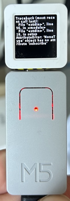

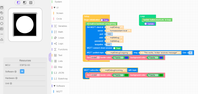

Hardware used is Atom S3, software - UiFlow2.
My UiFlow2 code:
Without "MQTT subscribe" block all else works.
Error when running on device:
Python code generated by UiFlow:
import os, sys, io
import M5
from M5 import *
from umqtt import *circle0 = None
mqtt_client = Nonedef mqtt_mqttDebugIncoming_event(data):
global circle0, mqtt_client
circle0.setColor(color=0x009900, fill_c=0x009900)def setup():
mqtt_client.subscribe('mqttDebugIncoming', mqtt_mqttDebugIncoming_event, qos=0)M5.begin()
circle0 = Widgets.Circle(62, 62, 50, 0xffffff, 0xffffff)mqtt_client = MQTTClient('mqttDebug', 'homeassistant.local', port=1883, user='mqttdebug', password='mqttdebug', keepalive=300)
mqtt_client.connect(clean_session=True)
mqtt_client.publish('mqttDebugOutgoing', 'This works, broker receives message!', qos=0)
circle0.setColor(color=0x3333ff, fill_c=0x3333ff)def loop():
M5.update()if name == 'main': # Forum message formatter messes this up
try:
setup()
while True:
loop()
try:
print_error_msg(e)
except ImportError:
print("please update to latest firmware") -
Can't subscribe to MQTT topic
Can anyone demonstrate the example for subscribing to certain MQTT topic? All I'm getting is an error: "'NoneType' object has no attribute 'subscribe'". Meanwhile publishing to MQTT works as it should.
