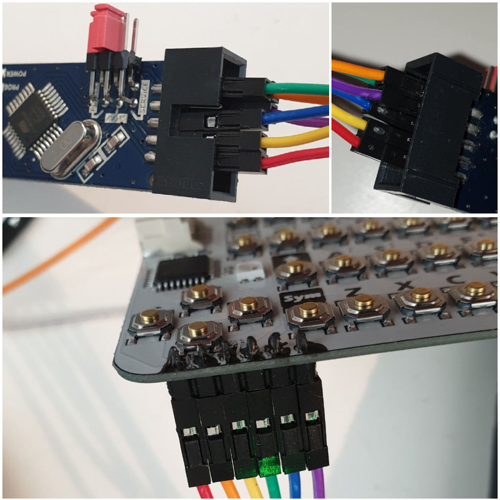

Yay, been on the docs subdomain, missed this one. Thanks :)
~Â î‚°Â avrdude -c usbasp -p atmega328p
avrdude: AVR device initialized and ready to accept instructions
Reading | ################################################## | 100% 0.00s
avrdude: Device signature = 0x1e950f (probably m328p)
avrdude: safemode: Fuses OK (E:F9, H:D8, L:C2)
avrdude done. Thank you.
