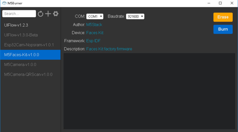

Use M5Burner to restore your firmware to the factory program
Erase , and then Burn.

RE: Help! How to repair bootloader?
