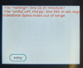

RE: M5 Core2 and unit UHF-RFID are bugged in UIFlow (bytes index out of range)

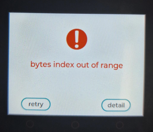

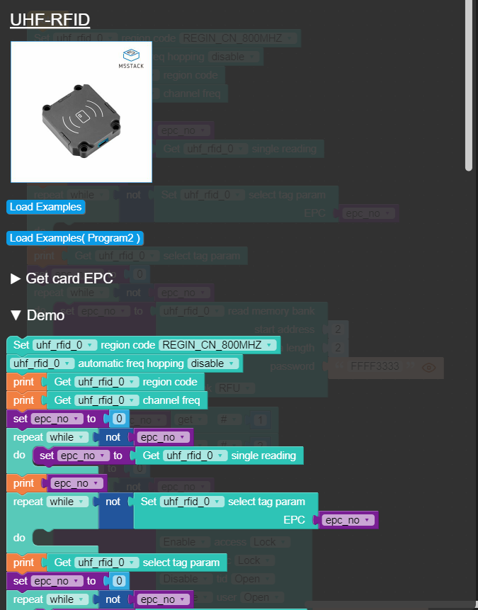

The default testing code does not work, something seem to be wrong in "units/_uhf_rfid.py"
Changing the region does not help.
Removing the region just moves the error tot the automatiq freq hopping step.Can someone help me figure out how I can find and edit the units/_uhf_rfid.py on the Core2?
