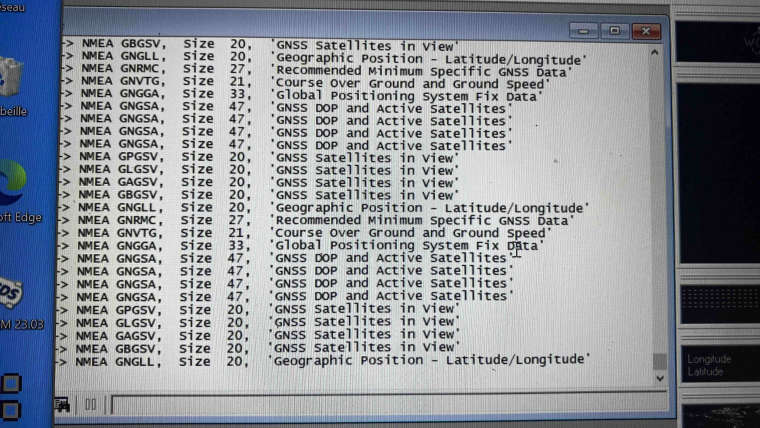

I connected the module to the u-center app to have more information, but nothing helpful here.
The GNSS module does not see any satellite (GSV sentences).
Is there any GPS expert able to check the configuration ?

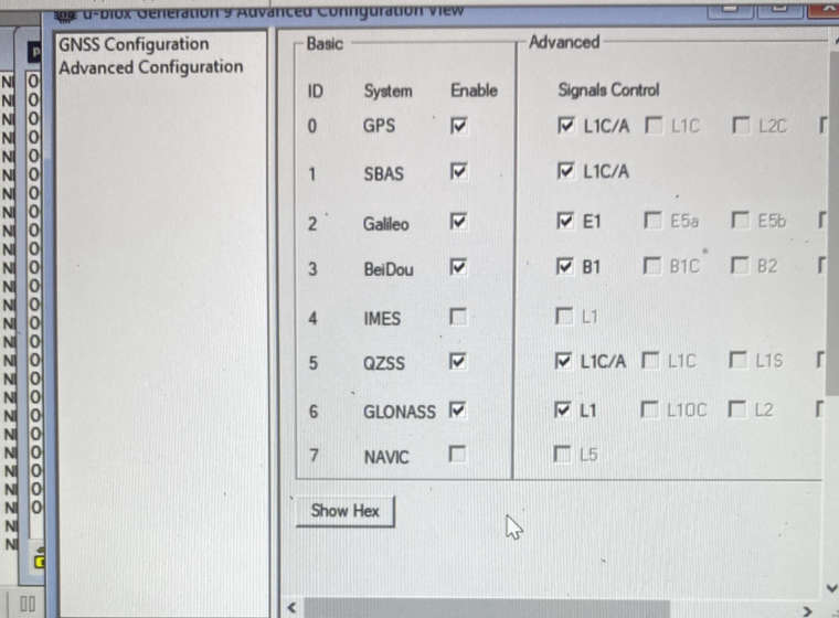

RE: Unable to read data from GNSS Module with Core 2
@robski yes I did. At 38400 I have a communication with the GNSS module. At other baud rates, I've got nothing.
Issue is not to communicate with the module, it is that the module does not return any valid position.After some researches, my understanding is that I need to find out how to configure the GNSS module to make it work in my location (France). It seems that the actual configuration does not work. I'm learning the uBlox PBX commands as we speak.

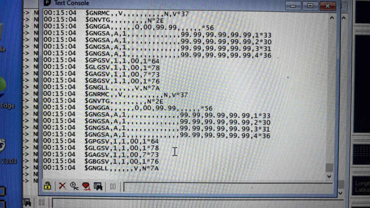

@unumdesignum The data returned by the GNSS module in ASCII:
$GNRMC,,V,,,,,,,,,,N,V37
$GNVTG,,,,,,,,,N2E
$GNGGA,,,,,,0,00,99.99,,,,,,56
$GNGSA,A,1,,,,,,,,,,,,,99.99,99.99,99.99,133
$GNGSA,A,1,,,,,,,,,,,,,99.99,99.99,99.99,230
$GNGSA,A,1,,,,,,,,,,,,,99.99,99.99,99.99,331
$GNGSA,A,1,,,,,,,,,,,,,99.99,99.99,99.99,436
$GPGSV,1,1,00,164
$GLGSV,1,1,00,178
$GAGSV,1,1,00,773
$GBGSV,1,1,00,176
$GNGLL,,,,,,V,N7A -

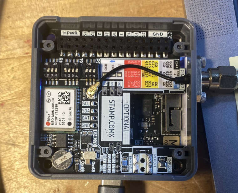

@robski Thank you for your message. I tried to set dip 1 to on but without any success nor changes.
(I actually wonder what this PPS is)There are data coming out from Serial2, but it seems that they cannot be decoded by tinyGPS.

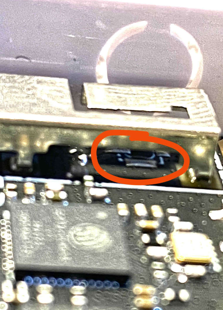

RE: M5Stack Core 2 External WiFi antenna
If you carefully look under the 3D antenna, you can see there are pre-soldered areas that look like for receiving an U.FL connector. Quite challenging to access to though. Maybe desolder the 3D antenna first.
