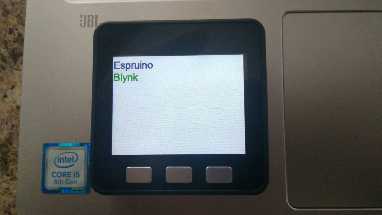

RE: How I can run espruino / javascript on the M5 Stack?
If anyone is interested in Espruino on M5Stack - check out this initialization code:
https://gist.github.com/vshymanskyy/49accf6355900346fd1418336d6be86eIt initializes the display, but currently the display works rather slow due to Espruino limitations (hopefully will be fixed in future).
Also stops the annoying noise! ;)
