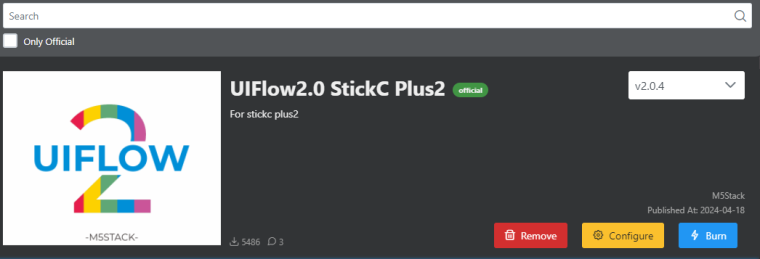

And maybe also upgrade to version 2.0.4:
The problem is that I created a fairly large project in Flow 1.13 using functions that are not in Flow 2. Therefore, the question is rather how to implement deep sleep specifically in Flow 1.13. And I don't understand why the standard function doesn't work(
