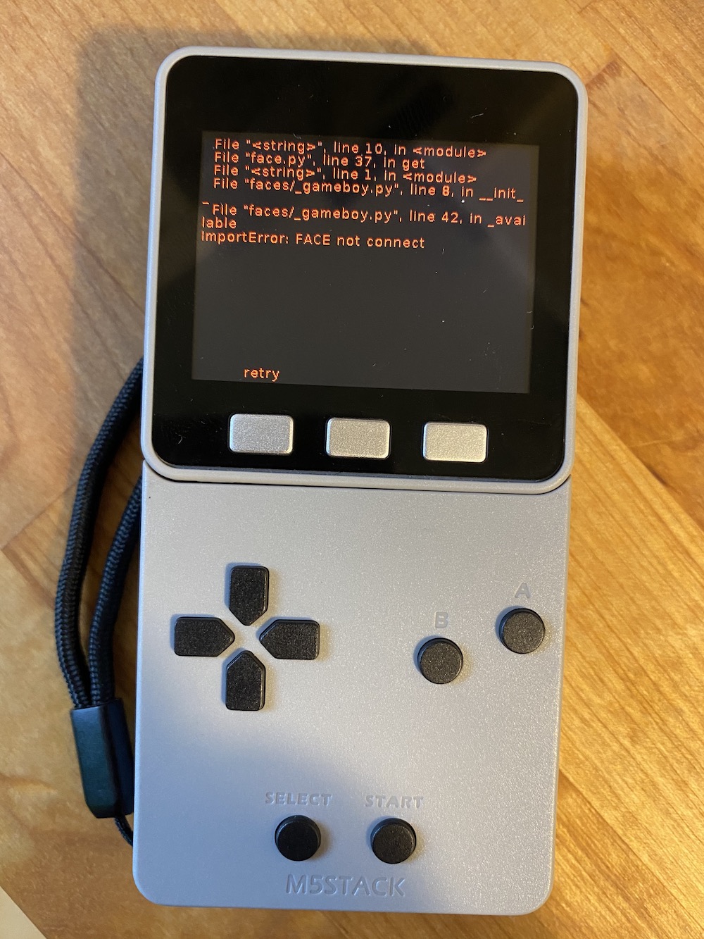

After this, I got this prompt:
[image: 1705265750188-faces-mpy-resized.jpg]
The OSError is due to a missing main.py. After adding this with mu-edit, the error no longer occurs.
