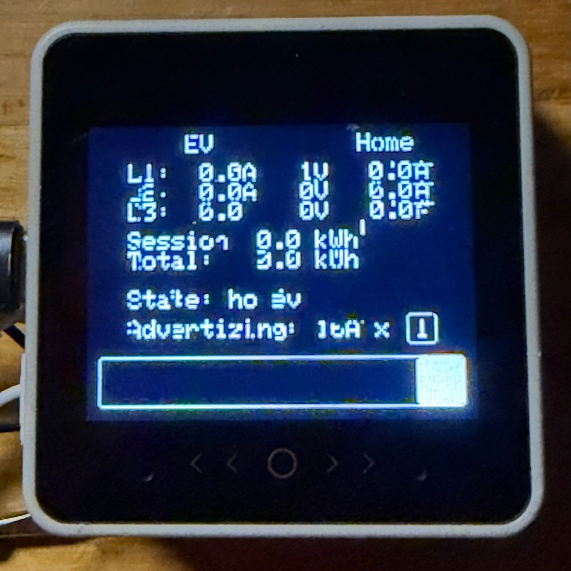

    P
    [image: 1772814000502-7e5ce5b2-8d9d-48f9-ae34-7fa5884c1e12-image.png]
