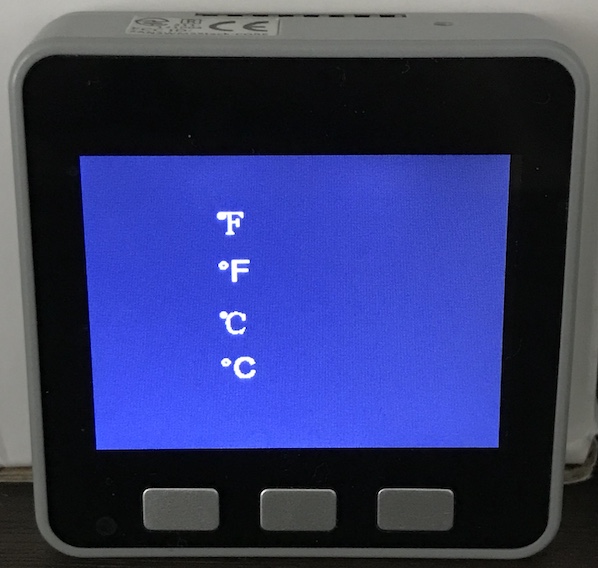

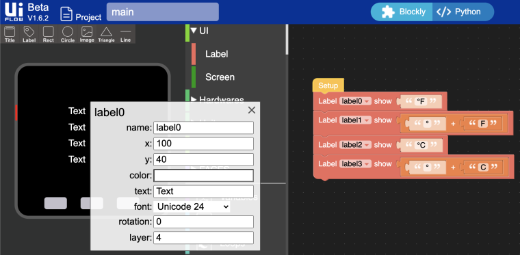

                          Just an update. I noticed that uiFlow now supports Unicode characters. I'm not sure in which release it was introduced, but I'm now able to add the degree symbol to a label using characters from this site.
                          Two drawbacks...
                          • Size is fixed at unicode 24 (similar in size to DejaVu 24).

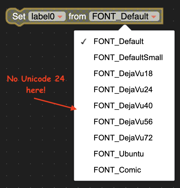

                          • Unicode 24 is missing from the label set font block
