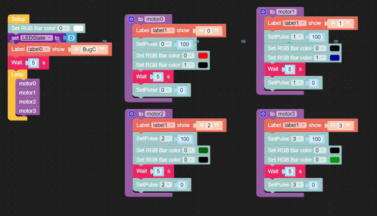

      I have tried both UIFlow and the demo Arduino program and both have problems. Starting with the UIFlow it is a simple program just to test that the motor controls work.0_1586147983050_Capture_Software.JPG In this program it justs loops through the functions: motor0, motor1, motor2 and motor3. At each function it is meant to pulse the motor for 5 secs and turns on and off RGB LED patterns on the two LEDs. The problem is that the program stalls on the first function and does not continue. Motor0 stays on. If I remove the motor control statements the loop completes and repeats and the various patterns of the RGB LEDs work. Could the motor control hardware be defective?

        @dsrc12 thank feedback. we will fix this UIFlow bug as soon as possible. about the BugC Arduino example compile problem . you could trought clone the laster version lib to solve it.
