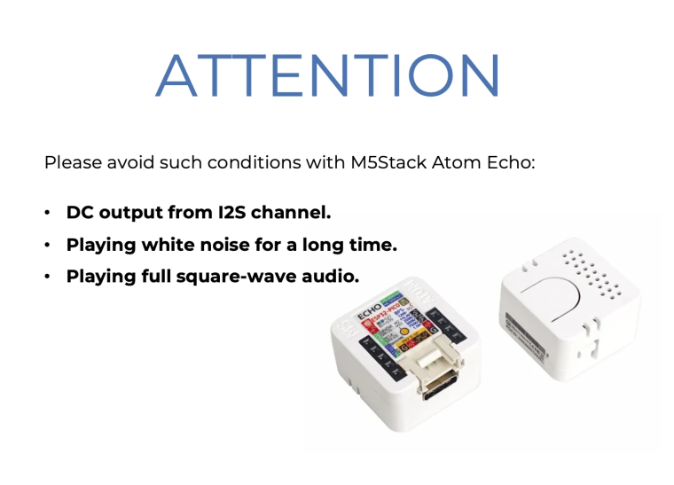

              • world101W Offline
                world101
                @m5stack regarding the Attention note, will it damage the Atom Echo to play streaming music over BLE for long periods (several songs or hours of streaming music)?
