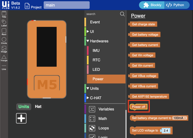

        There is a "Power off" block in uiFlow if your device is the M5StickC, M5StickC-Plus, or Core2 since they have the newer AXP192 power management chip.

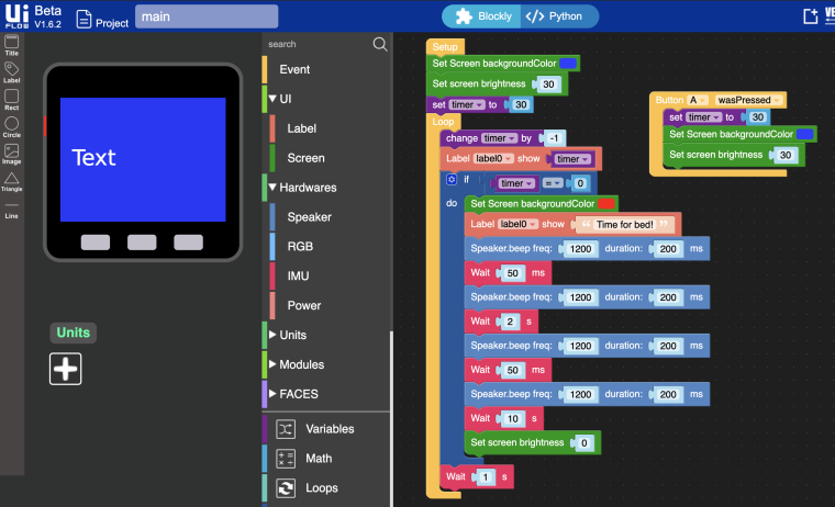

        • Just turn the screen off (brightness=0) after the timer exceeds the set time. Then you could use a button callback to turn the screen back on and reset the timer.

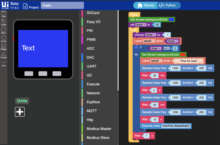

        • Have the device go into deep sleep after the timer exceeds the set time by using the Execute block. This will essentially shutdown the M5Stack. To turn it back on, tap the red power button once and it will boot-up and start the last running program again (assuming you Downloaded the program to the device and the device is in App mode).

          I indeed have the Fire version, so that's why I'm missing the power off block. As you suggested, I just hooked in the Execute code block with "machine.deepsleep()" at the end of my flow, and it works perfectly. Tomorrow my son gets to pick the led colours so he'll get a bit more involved, after that, this project is done =)
