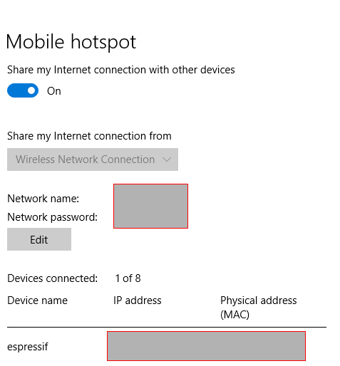

RE: M5Stack FIre Wifi can not connect
I think the underscores are indeed the issue. I just did a test in which I used my pc as a WIFI hotspot, and the M5Stack connects properly now. It's a weird thing underscores can't be used in the SSID...

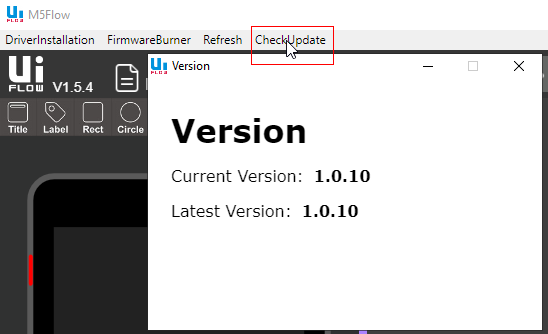

RE: UIFlow 1.5.4
@m5stack Thanks, I found it, it was a bit hidden =)
Maybe it should be a bit more clear 1.5.4 is a beta version? Maybe add a "b" after 1.5.4? Before I also tried the following option, but that's a completely different revision number

RE: UIFlow 1.5.4
What's the latest stable (non beta) release of UIFlow, is that still 1.4.5? (When I download the version from https://m5stack.com/pages/download , I get 1.4.5)
