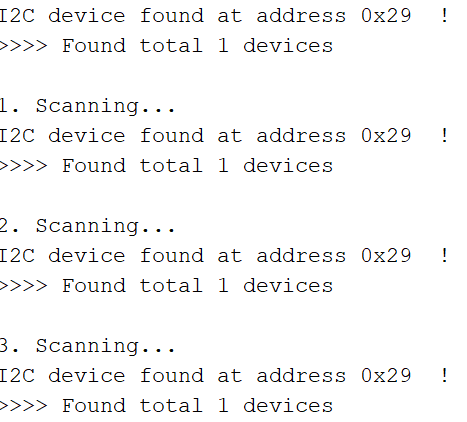

      Hey, Here's my result. My Gray Core works well.
      https://github.com/tackelua/I2C_Scanner/blob/master/I2C_Scanner.ino

        @watson without any chance for me
        With ToF unit connected:
        With disconnected ToF unit:
        What is 0x75 in your listing?
        m5-docsM 1 Reply Last reply Reply Quote 0

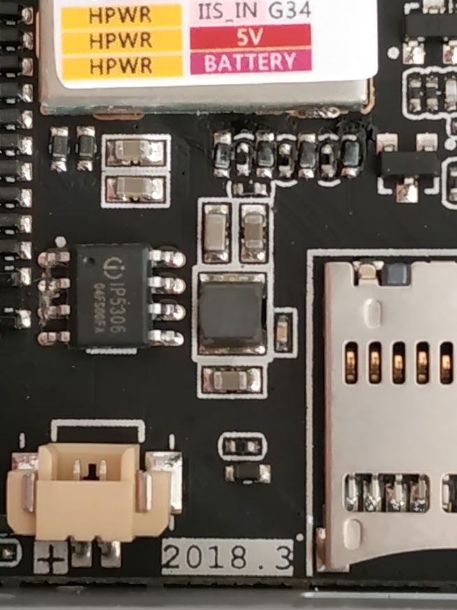

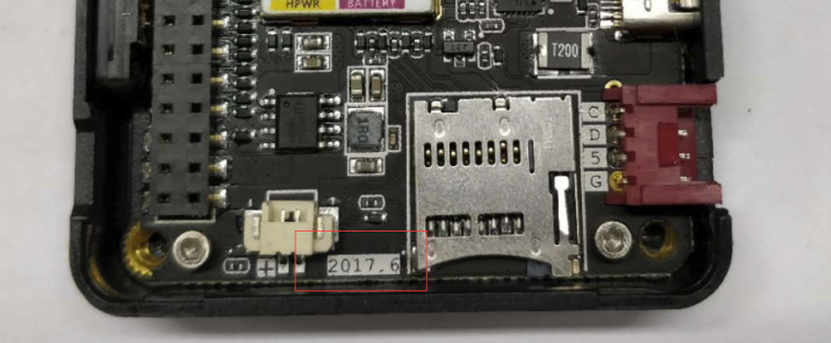

                What's the hardware version of your basic core?

                      @vvs551 Could you make a picture of the TOF PCB? The schematics are not yet available
                      I have a hypothesis on all this I2C issuses.
                      But before just to exclude software bugs, please check to use the latest ESP32 Arduino core, at least V1.0.1 https://github.com/espressif/arduino-esp32/releases including all the recent I2C fixes.
                      V 1 Reply Last reply Reply Quote 0
