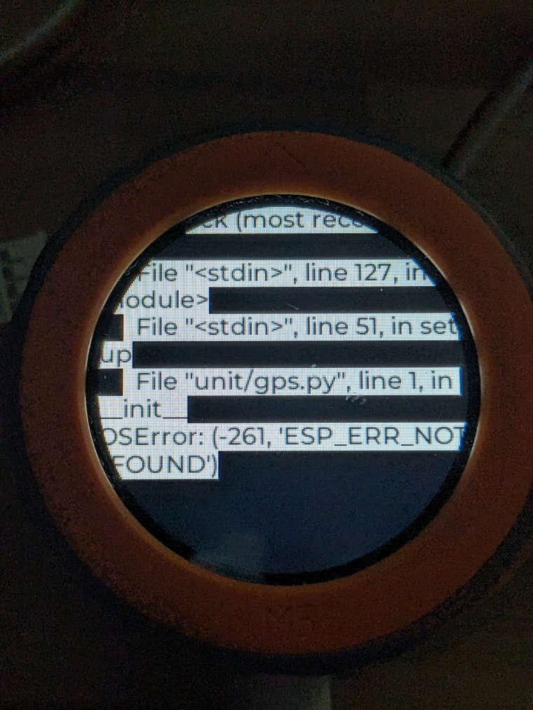

        For what it's worth, I'm getting roughly the same errors as I got when using UIFlow 2.0.2 and Dial firmware 2.0.2. I was able to get things working by burning 2.0.1 on the Dial.
        This is with 2.0.3, the only available firmware in MBurner:0_1711155168441_PXL_20240323_003554341.jpg

          sad but true. I can confirm that UART (id=1) in general is broken in M5Dial UIFlow2.0.3 firmware.
          Note: M5Dial UIFlow firmware v2.0.1 was the last version where UART (Id=1) worked. In other words: It seems it got broken starting with v2.0.2 (as @BrianR stated).
          @m5stack : please fix. Thank you.
          Note: UART (id=0) is used for REPL connection and debugging, so not an option.

            after long hours of searching and trial and error I think I found the reason UART is broken on M5Dial UIFlow2 firmware v2.0.2 and later. At least the fix works for me. I've created a PR for M5Stack engineers to consider.

                                  I have contacted support, and they offered 2.0.4--hotfix to test, but neither that, nor 2.0.4, resolves this issue. They should be able to easily recreate this problem on their end, but I'm happy to keep testing for them.
                                  Problem easily seen by burning new firmware from Burner, then create a new UIFlow2 project, and just add the M5Stack GPS to Unit, and hit Run. Errors. Take the "Init gps_0" out of the setup block and hit Run, and it loads the expected black screen. Add it back in, it errors...
                                  Again asked for 2.0.1, even just temporarily, as a testing control to ensure that there is a firmware this worked with. We'll see...
                                  • felmueF Online
                                    felmue
                                    Hello @BrianR
                                    that is not what I am seeing. With M5Dial UIFlow firmware v2.0.4--hotfix my GPS example in the Project Zone runs just fine. M5Dial_GPS_Unit_UIFlow2.0.2
                                    Edit: Just double-checked:
                                    • Erase, burn UIFlow2.0.3, new project, add GPS unit, run -> error
                                    • Erase, burn UIFlow2.0.4--hotfix, new project, add GPS unit, run -> no error
                                    Thanks
                                    Felix
                                    Code examples
                                    • B Offline
                                      BrianR
                                      @felmue , I just spent a bit of time struggling to get any firmware to load onto either Dial that I have, but I finally got the --hotfix firmware loaded, and I can confirm that the GPS now works again!
