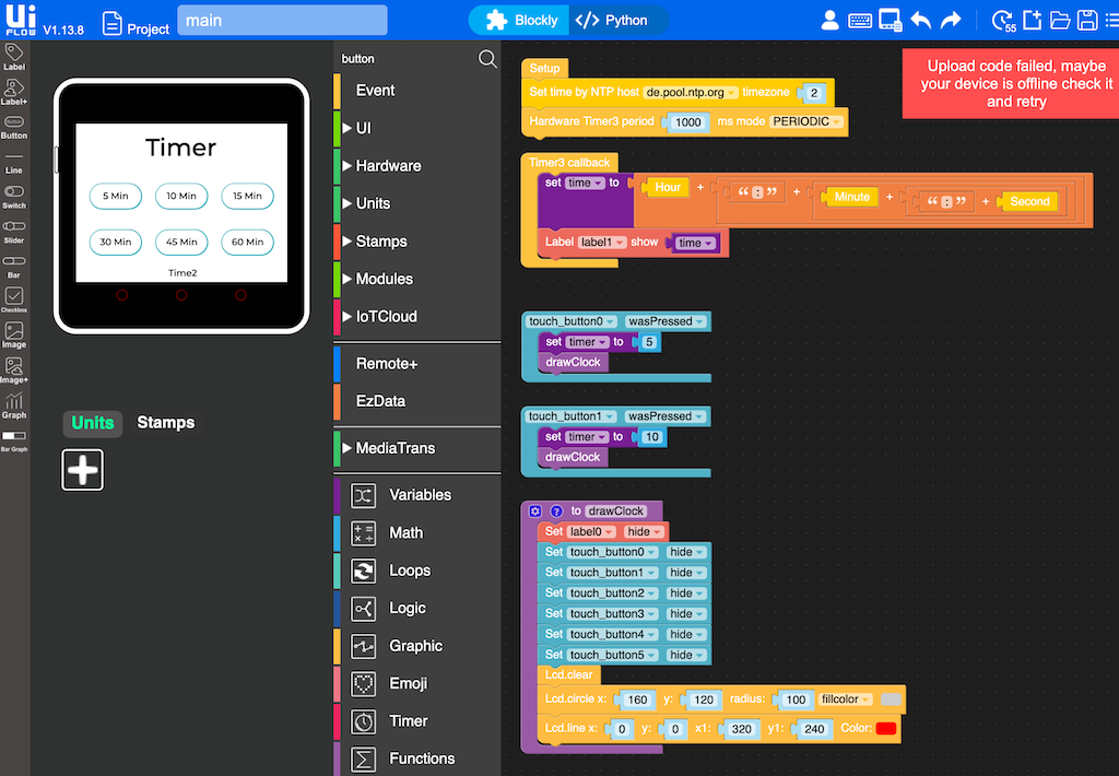

      I am trying to use a timer in UIFlow to show the current time. When using "Run" in UIFlow web IDE, it will upload and run the program on Core2 once.
      But every time I try to "Run" again, when the program is already running, I get an error in UIFlow web IDE: "Upload code failed, maybe your device is offline check it and retry"
      I tried with both the hardware timer and the software timer. I also tried a loop with "Wait 1s". But every time I do this, the UIFlow web IDE can't upload anymore, it worked perfectly before.
      What should I change in my code to have the device work with UIFlow web IDE and use a timer to update UI every second?

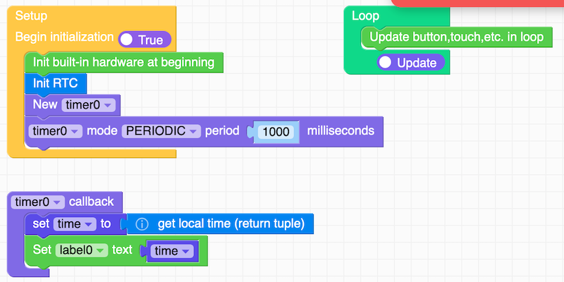

                  @robski Found and added RTC and Timer. In UIFlow v2 the WiFi connection still works when using the timer and updating a label every second. I can still update and run code.
