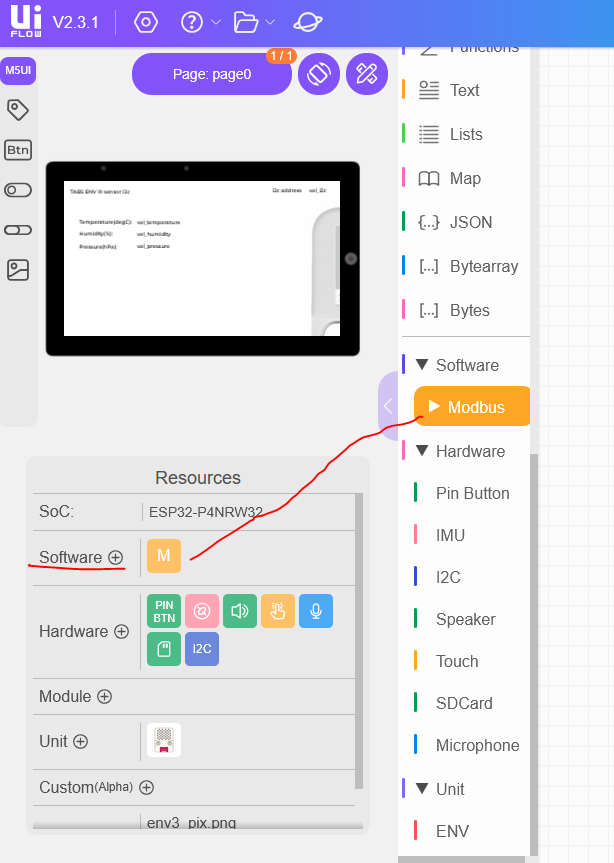

          • felmueF Offline
            felmue @scroggyg
            Hello @scroggyg
            I created a Modbus example for M5Tab5 controlling an ACSSR relay. You can find it in the UIFlow Project Zone: M5Tab5_Modbus_ACSSR_Test_UIFlow2.3.1
            Thanks
            Felix

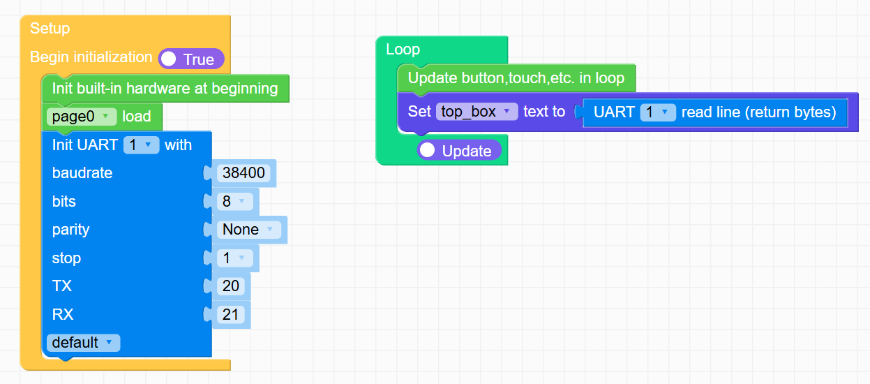

            • P Offline
              pestarius @scroggyg
              @scroggyg Hi, the SIT3088 is a "converter" from UART to RS-485. To write/read the RS-485, use the UART1 (TX:20, RX:21).
              The setup below works, although I have to store the arrays first somehow, before setting them into my text box (top_box), as the text appears briefly and then disappears ...but I can see I am receiving OK.
              I got the tab5 yesterday ...and RS-485 was the first thing I wanted to test it.
