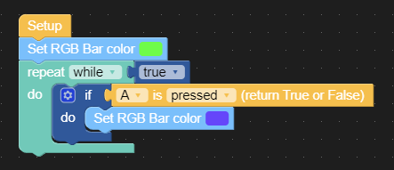

Hello,
After creating an infinite loop in UIFlow, and executing it. I am unable to then execute new code subsequently. UIFlow says 'Execute code successfully', but state of the device does not change. The only solution I found was to power-cycle the device. Are there any software workarounds?
HW: Atom Lite.
SW: v1.12.9
WEB: 2023.12.8 https://flow.m5stack.com/
